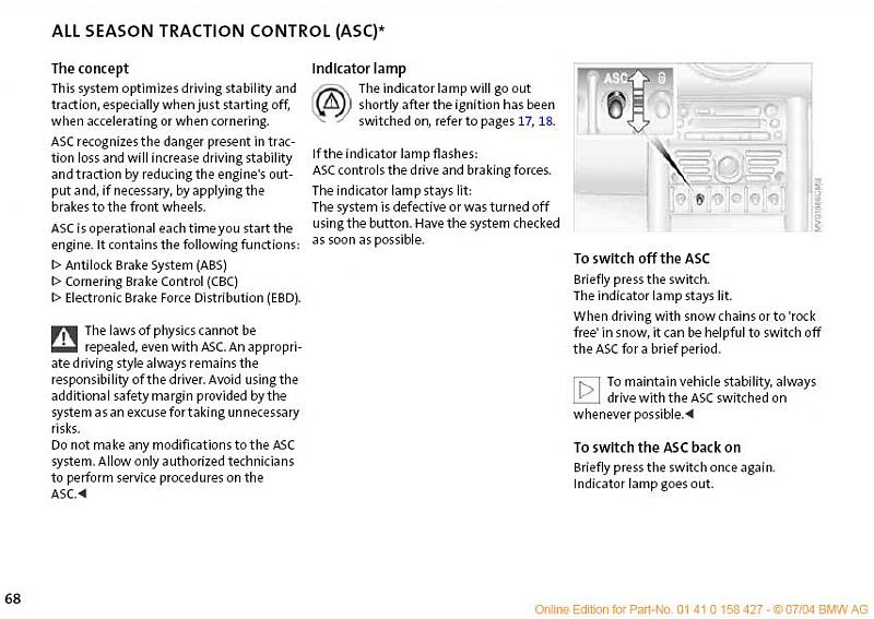

Well you missed something then cause I'll quote you from page 72 of the manual
"ASC prevents slip at the drive wheels while starting off and accelerating the vehicle. ASC also recognizes unstable vehicle conditions, such as fishtailing or nose-diving. In these cases, and subject to physical limits, ASC help to keep the vehicle on a steady course by reducing engine speed and by applying brakes at individual wheels.This system optimizes driving stability and traction espescally when just starting off, when accelerating or when cornering."
And even MINI acknowledges it wont help you defy the laws of physics.
Both systems fit what the study covered and I find the "less intrusive" ASC system to still be over bearing.

What manual are you reffering to? My 04 says nothing like that. And from the current website it basically says that ASC is a traction control system. My manual does say ASC will brake the front wheels only, but not independently nor the rears as DSC will do. The cornering statement has to do with the traction control, not braking of individual wheels.
Page 72 of the 05 Manual I'll see if I can pull a screen shot off of the OL....
Here is the page from the manual with a copyright of 2004
Still talks about aplication of the brakes. My manual is copyrighted 2005 and is updated and reads just as I typed it 4 pages later in the new version.
