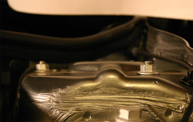

Can someone post a picture of a normal and a mushroomed strut tower side by side?

Here is a picture of a severe mushrooming case. You can tell what a flat one should look like from this one. The bolts and nuts should be upright and straight, not pushed over like a tree after a tornado.

You guys are freaking me out. I have a 17" rims and run flats. Based on the photo, I haven't experienced mushooming yet. (Bought a 2006 MINI JCW in August.)

I have to admit that I, too, remain a skeptic.
My '05 MCS has the 17"/runflat combo. Despite my best efforts to avoid impacts, I've hit a few teeth jarring crevices here in LA. It is virtually impossible to dodge every crater and gap on these horrible, horrible roads.
To the best of my ability I have not detected any change in my strut towers. I've taken four sets of photos over approx two month intervals and simply can not tell a difference.
Now . . . perhaps I'm lucky, but looking at some of the photos posted on this thread I have to ask just what are these drivers doing with these cars? Jumping over school buses? I'm used to driving over curbs and obstacles in my '91 Trooper (my UAV . . . urban assault vehicle), but even with this truck I don't simply hit the curbs at high speed.
Maybe I'm just lucky . . .

the first image was 11/16/06
the second 1/07/07
in between these . . . I can think of at least a couple of impacts which gave me pause . . .
Am I wrong . . . or is there virtually no change?
the second 1/07/07
You're safe. It depends on what you want to do now. Just becareful with those potholes and stuff.
