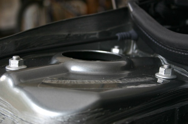

. . . Not certain that I can tell whether this is occurring on my car: '05 w/17" runflats . . . low miles
is there any difference here than depicted on MiniMacPR's photos?
I'm pretty good about dodging pot holes and taking it easy on rough road. Can hard cornering do the damage as well?
Attached Thumbnails Poll: Mushrooming/strut mount failure data collection-driver_angle.jpg   Poll: Mushrooming/strut mount failure data collection-passenger_angle.jpg
You certainly appear to be tempting fate (with the 17-inch wheels and runflat tires).
In terms of do your strut towers show mushrooming - they don't appear to be; however, the only way to conclusively tell would be to put some re-inforcing plates on and see if there is any mushrooming.
Safe driving practices seem to have avoided the dreaded disease (mushrooming). But if it were mine, I would either loose the runflats and 17 inch wheels or invest in a set of re-inforcing plates. Or, better yet - re-inforce from below with a set of camber plates. Also, there is the risk of cracked strut mounts inside the strut towers. Reinforcing plates won't stop that (strut mount failure) from happening.
I'm not trying to tempt anything . . . I'm more than a bit concerned about this issue . . . and, mushrooming aside, have wanted to add a STB in addition to other upgrades. No real interest in the 16" wheels . . . at least I haven't been looking in that direction.
16 inch wheels are a consideration insofar as the tires will be taller (going from /45 series cross section to /50 series), which provides more rubber (the tire sidewall) to absorb road impact before it gets transmitted to the strut tower.
I'm also curious as to whether loads experienced in dramatic cornering can produce the same damage as a pothole?
Doubtful as the load from cornering is different (horizontal application of forces) than potholes (vertical application of forces). Although, if you hit a pothole while cornering, all bets are off....
A prior post questionned how the SRP's work. I'm not an engineer, but I can't quite grasp how the plate functions on the top of the tower.
There has been a whole line of back-and-forth in another thread between Dave and at least two of the people (Peter and Randy if memory serves) at M7 about which is the best way to protect from mushrooming the strut towers. Plates on top of the strut tower probably can be conceptualized as adding a re-inforcement that fights the urge of the strut tower sheet metal to give (bulge/mushroom) in response to road impacts.
Would it not have to be installed under the portion of the body work that the struts are actually mounted to make any difference . . . otherwise I imagine it could eventually get "punched" up, possibly stripping the bolts upon which it is mounted.
You have grasped the essential point of debate between Dave and the crew at M7. My personal belief is that the plates probably provide an intermediate level of protection against mushrooming. A more permanent solution would be to install camber plates under the strut tower sheet metal. If you were to install adjustable camber plates under the strut towers, you would gain a further benefit in that you could adjust camber and further improve the MINI's handling. Also, Ireland Engineering sells a fixed camber plate that has a mild amount of negative camber but has a more robust strut mount (the rubber thing that is also prone to fail in addition to the mushrooming). The reinforcement plates will do nothing to stop the rubber strut mount from failing in response to road impacts; so, the best solution in my mind is the Ireland Engineering fixed camber plates with the more robust strut mount.
What do I know? Not much.
Don't sell yourself short. You were able to think through the issues and ask relevent questions.
