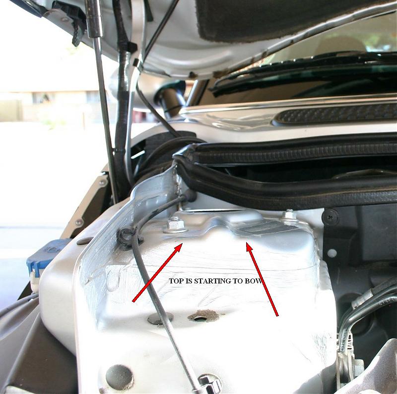

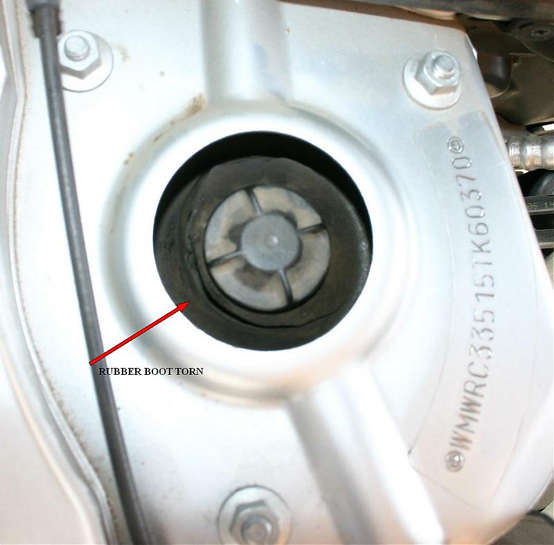

I've just learned that I've been driving my 05 Cooper with 17" non-run-flats with a bent strut and mushroomed and torn mount for almost a year.
Dealer wants $1450 to fix it, even though the car is barely driven (19k miles).
Clearly the suspension is too stiff and/or the strut towers are not reinforced to accomodate such a stiff suspension. If this car was designed for track-use only, that would be acceptable. However, this car suffers full and complete catostrophic suspension failure in regular driving scenarios on public roads that other, similar cars in the same scenario (from other manufacturers) do not suffer any damage what-so-ever.
If your MINI has suffered from any of the suspension damage mentioned in this thread, the NHSTA wants to know about it.
