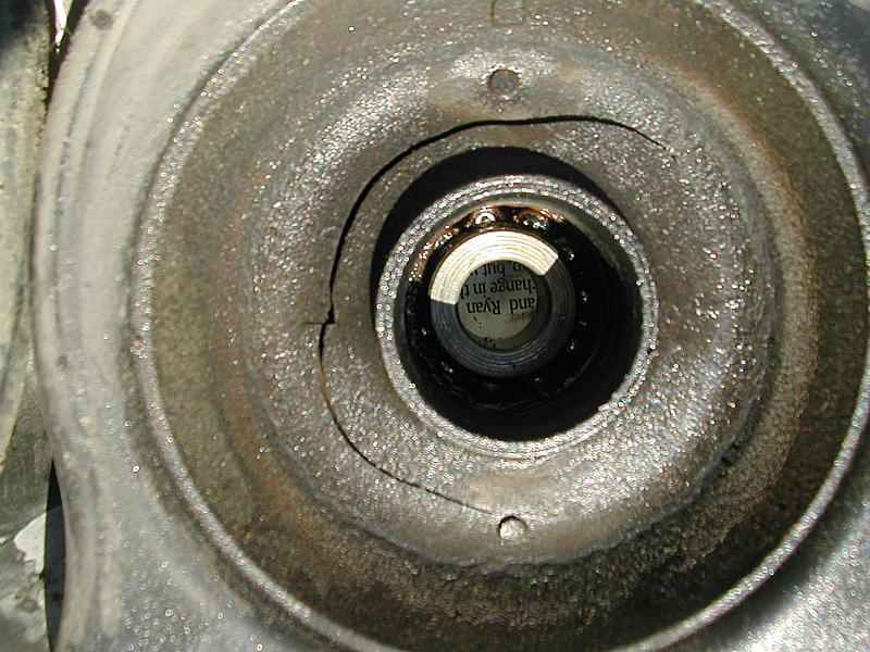

Crack Strut Mounts
I only have the car 1 year 12000 miles & have crack strut mounts. i keep the car in perfect condition, car cover & cones around the car & garaged!. brought it back to the dealer to complain of a squeek & they replaced both strut mounts -> $1110.00 & not under warranty. tried to complain but to no avail.
17 " run flat tires
dealer say you have to keep on coming back to replaced the crack struts & adding a sway bar will not help - lol
please help me - what should i do

Well, your dealer's correct that adding a sway bar will do nothing to prevent the strut towers from cracking. In fact, there's no reason to think that one *would* help, so I'm going to assume that you really meant a strut brace.
In most cases, your dealer is right - a basic strut tower brace in and of itself won't add much strength to the sheet metal at the top of the strut towers. But, I don't know of anyone that uses the M7 strut brace or reinforcement plates that's had a problem with mushrooming or cracking after installing them.
Just from my own personal experience, my wife and I both have 2006 MCS convertibles. Less than 5,000 miles after getting my wife's car, I noticed mushrooming on her passenger-side strut tower. Right after that, I fixed the mushrooming and put on the M7 plates. When my car arrived a few months later, I put the plates on the day I brought it home from the dealer.
Her car has had no more mushrooming in the 15,000 miles since putting the plates on, and my car has gone 22,000 miles with the plates with no mushrooming at all.

Thank you scott for the answer, but do you install a strut brace @ the dealer or at a local shop?? danny

You can do it yourself - it's almost trivially easy. There are a total of six nuts you have to remove, and they're all the same size and very easy to get to. Then you put the brace in place and replace the nuts.

You can also do the strut plates yourself...
it's not hard to drop the struts. $1100 is a lot for them to ask for the job.
FWIW, I'd escallate this one to the manager or MINIUSA. I know it's the party line (mostly) to say this is from pot holes or the like, but if you don't have pinched sidewalls of your tires, or dented rims, you can make a case that it's the part, and not the driving or the roads.
Also, lodge a complaint with the NHTSA. If enough log the problem, there's a SMALL chance that BMW/Mini will have to eat some crow on this one.
Matt

I Love my mini cooper s conv 06, except for the cracked strut mounts $1100 not cover under warranty.

Love my car but the crack strut was not covered under warranty. Contacted my dealer & took the 1 month to reply from the service mgr & they will not cover it. contacted better business buerau & NHTSA. will update you when i have a result

Hi Scott
is it like this http://www.nyxracing.com/alta-front-...6-p-32279.html
Alta Front Strut Brace Mini Cooper S 02-06
[SIZE=2][AMP-SUS-500][/SIZE]
Our price: $208.99
Subaru Platinum MasterCard
Earn 3% in Subaru Reward Dollars on all Purchases!
Alta Front Strut Brace Mini Cooper S 02-06 description Alta Front Strut Brace Mini Cooper S 02-06
With something as simple and elegant as an ALTA Performance Strut Tower Bar, you can finish off the area under the bonnet and boost your handling all at once. This beautiful and brawny aluminum bar reduces front-end strut tower flex instantly. Youl feel the difference with every turn.
Includes:
-Bar
-2 cast feet
-2 name plaques
-4 bar bolts
-Instructions
-2 stickers
Specs:
Feet construction: Cast aluminum
Cross bar: Extruded aluminum tubing
Cross bar finish: High polish tubing
Feet labeling: Multi color Aluminum plaque
Mounting locations: 4, 2 on each tower
Danny
p.s. it was the strut mounts, whcik was not covered under warranty after 1 year
Attached Thumbnails Poll: Mushrooming/strut mount failure data collection-crack-strut-mount-both.jpg   Poll: Mushrooming/strut mount failure data collection-crack-strut-mount-l-closeup.jpg   Poll: Mushrooming/strut mount failure data collection-crack-strut-mount-r-closeup.jpg

Still wondering, if anyone removes the M7 plates regularly (or ever) to check the state of the shock towers or check the struts/suspension components for resulting issues based on the impacts that would deform the towers..
Old Dec 1, 2007 | 09:19 AM
  #273

Well, I've had mine off at least three times that I can think of - when I replaced the strut reinforcement plates with the full strut tower brace, when I installed coilovers, and when I removed the brace before taking the car to the dealer for service/oil change.
Everything still looks good. I really think that the struts themselves and the rest of the suspension components are up to the task - it's just the too-thin metal in the strut towers that's causing problems.

So the fix for mushrooming is pounding on the tower with a block of wood and hammer?
So after the fix, can I run the car with an aftermarket camber plates and no SRP or STB for a bit? They will be added on later but $$$ is always the issue
Old Dec 1, 2007 | 02:50 PM
You should be fine as long as you do your best to avoid any serious hits like pot holes etc. Also you should make sure your tire pressure is up to specs. Depending on which camber plates you have you will also get some additional support and be better off than you were in the stock condition. Worse case scenario is that you might have to get out the old 2/4 and hammer before installing the brace when you do get it.
