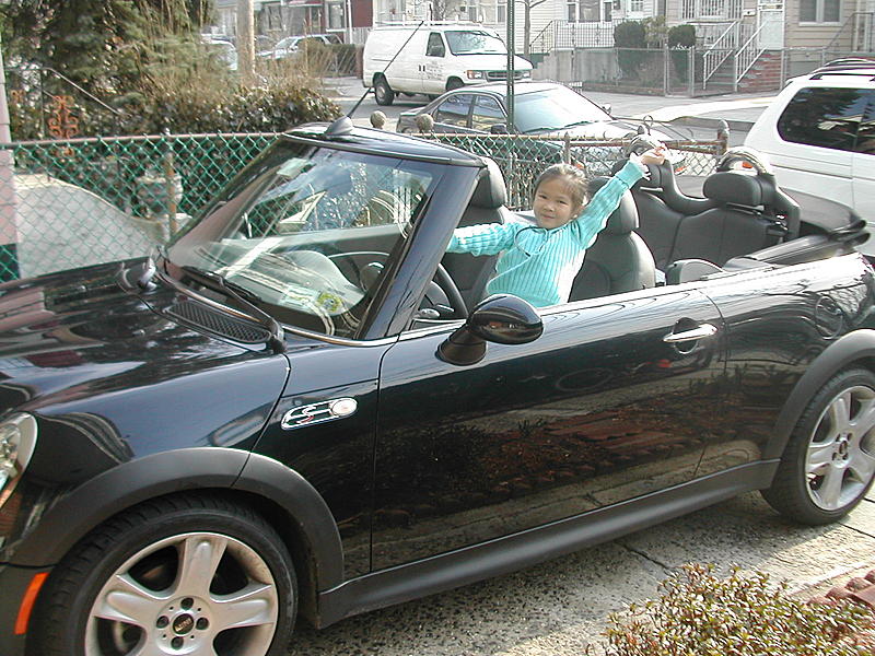

Hard to Start
In the winter the car start ok
In the summer it takes a little longer to start sometimes
2006 mini cooper s con
