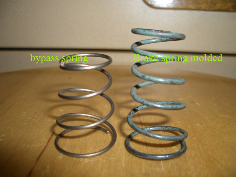

OK. here is the $5 fix until the real part arrives....which I hope is REAL soon.
Yes, it is crude but effective.
And yes, I have lost about 2-3 MPG on the highway. It is a fairly weak spring so it should allow the valve to open. I adjusted it so that it just closes the valve when the car is off.
I also noticed tonight that the bracket was rubbing my air duct. Hopefully the tape will help.
Come on MINI, I want a new BPV that will not do this again!!!
The spring came out of a "HELP" throttle return springs package #59002 from a local auto parts store.

Problem Solved
In reading over the last six pages it has become clear to me that the problem is one & only one thing, I've seen it many times & it's happened to me once, The Problem "Inverted Polarity" brought about by "Internal Osmosis"
not easy to find & even harder to fix....... :impatient
