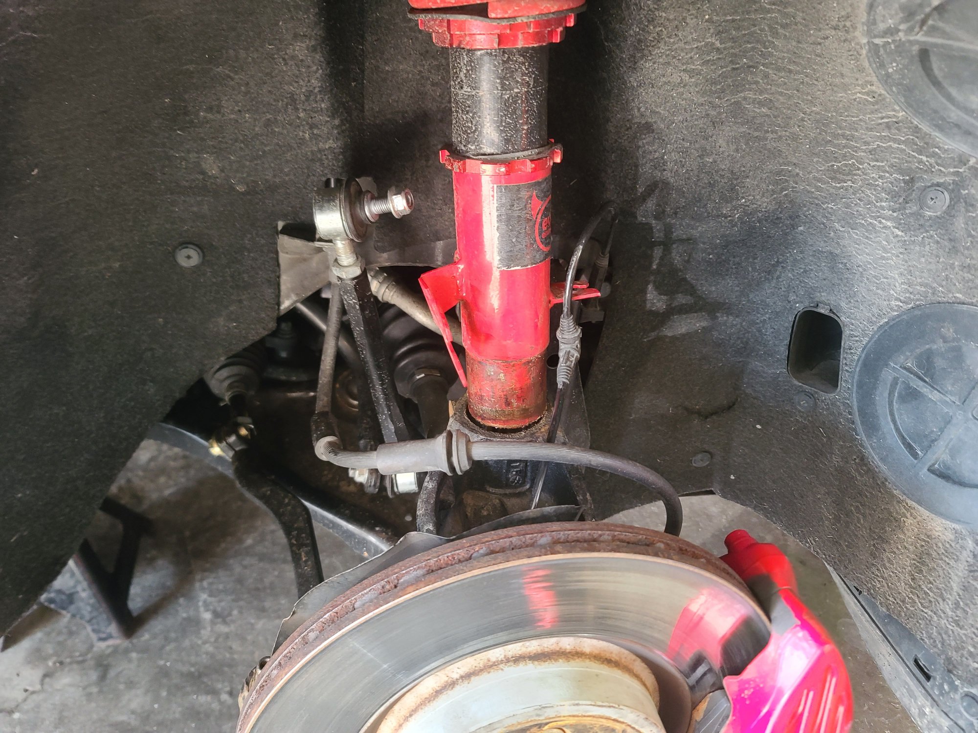

I DID find a finger tight top nut on the engine mount AND the strut mount bolt rusted and literally backed off 2x threads and I think that could have been enough for my coil to move in the knuckle, idk if fixing those 2x things made the noise go away but soon as i can test drive the car again I will..
I also did put in all new interior clips and even packed foam behind certain panels to stop ANY interior rattles ( im very **** about things ) and yes , new swaybar bushings and I even replaced the endlinks because I accidentally tore the boots on my old ones. But lol EVERYTHING upfront is new and everything in the rear is too with expectation of rear trailing arm mount bushings. New tires n rims too !
the oldest suspension/steering stuff on my car now minus those rear bushings are the coilovers amd theyre maybe 6x months old and under 5k miles..
it was 70'F 2x days ago and now its 30 amd were getting a blizzard UUUUGGGHHHHH. I wanna get this figured out.
i also had to put it on hold because my oil pressure light came on so i HAD to address that immediately.
here's my car and how it sits although I did drop the rear end and leveled out the car more.

It WAS the coilover. I narrowed it down by swapping coilover from my r55. It turned out this stupid slide type nut thing wasn't seated all the way. So I had to disassemble the coilover and fix it.. baaaaaaaam !
it's fixed ! Absolutely noooooo noises now what so EVER !
