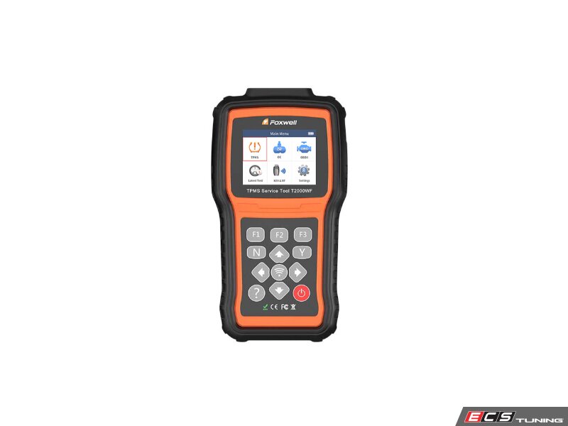

10 years average, i just had an aftermarket/ OEM go after 5 years Huf brand. :( It happens. My other three are fine and you can test the with this type tool after you first see what the error is with then schwaben scan tool below.. Go into test sensor and stick the head of the unit right by the tire/ valve stem.
If it reads its good. If does not read its bad and need replaced. Some shops have these TPMS universal testers.

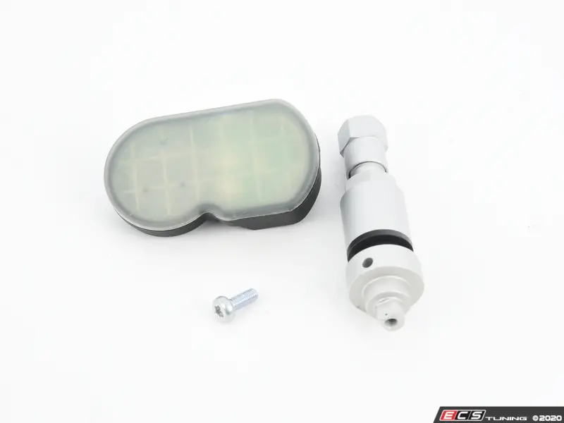

Huf (OEM) - No reprogram, just install and reset you inside system. split year in 9/2009. You have a 2014, 9/2009+ sensor.
https://www.northamericanmotoring.co...nd-11-r55.html

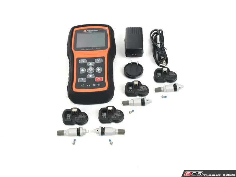

Or universal program them yourselves. Replace all four or just 1. You need that tool to program the universal schwaben foxwell ones.
https://www.ecstuning.com/b-schwaben...etal/t10003kt/
You could just replace the one thats bad with a Huf one (no schwaben programmer needed)
OR just replace the one that bad. 9/2009+ Huf sensor metal stem.
https://www.ecstuning.com/b-huf-part...106856227~huf/
with just one of these and then it will need programmed. The programmer we sell, i dont know if any shops local might have a programmer. Otherwise we carry it.
https://www.ecstuning.com/b-schwaben...tal/ad177~fxw/
Then this version for NON NAVIGATION CARS
Then this version for NAVIGATION CARS/ Full display car MINI.
https://www.ecstuning.com/b-schwaben...n/t2000wf~scf/
They usually just go bad. Ours dont sit on shelf long as people are always buying these things. Aftermarket wheels and all.
