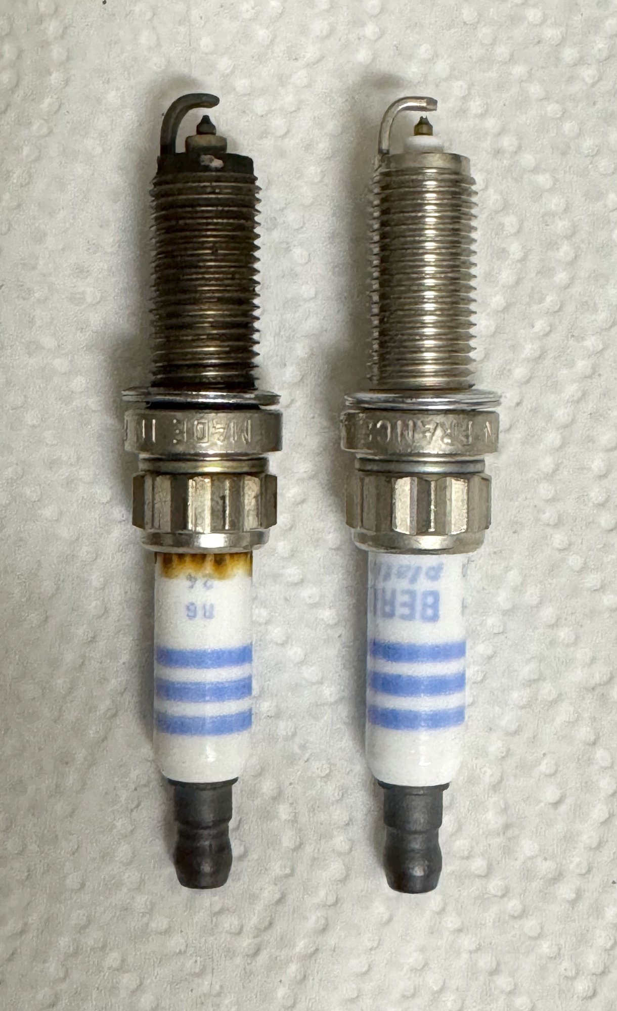

Well . . . a bit soon to confirm but after an initial drive it seems changing the spark plugs have solved the issue.
I'll monitor it in the next few days but so far so good!
Here the number 1 cylinder spark plug vs a new one.
And the four old spark plugs. We can tell that number 1 which was noted in the codes is in the worst shape than the others.
Now lets cross fingers that's all it is!

oh and btw, I wonder if the dark area around the base of the ceramic, by the flange, would indicate a park plug internal failure to the point where cylinder compression gas would be reduced. possibly exacerbating further misfiring?

Number 1 plug tends to cop the most heat, and fails the most
It would seem! Good to know it's a common issue...
