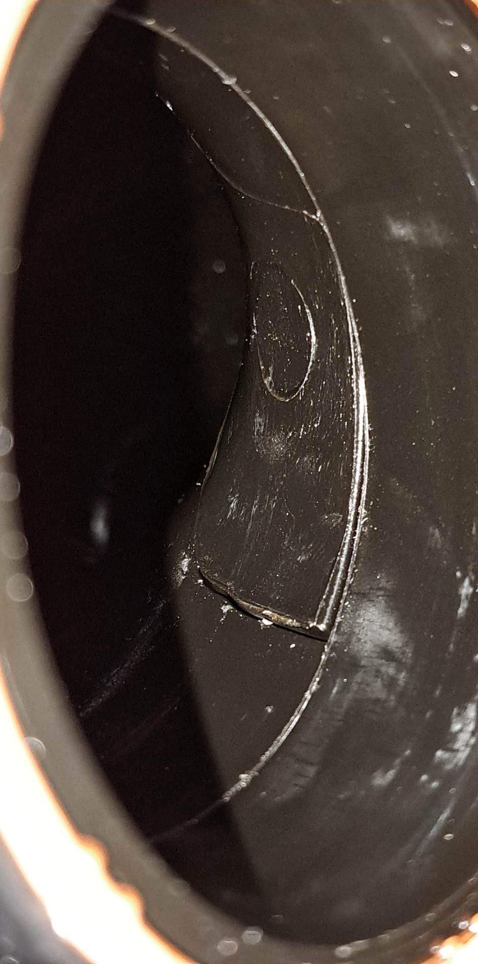

Mystery port on intake
I have a 2009 Clubman S that has been giving me fits to correct an intermittent stalling problem (Original problem). This is after pulling and reinstalling the engine, so I’m hunting for things I might not have reconnected. I noticed on the intake manifold that there is a port that is not hooked up (yellow arrow in pic). This isn’t coolant, as there is no leaking. is this a vauum port that I haven’t hooked up? I cannot find any hoses that are not connected, and I can’t find the connections on realoem.

This question comes up every now and then... That is a blind port that is not used on US vehicles. That port is only used in other markets.

Yep dummy port for the MINIs. Shared intake with PSA France, their is two different version.

Thanks for the clarification. Unfortunately, I was hoping this would solve my other issues, but I guess I can rule this out now.
