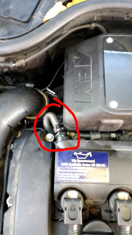

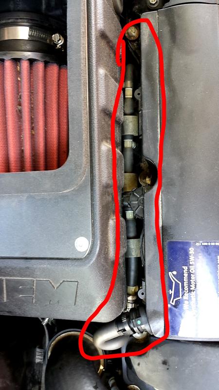

I have attached 2 pictures of a hose I am looking for. I cannot find it anywhere. All the hoses I find are solid, but mine has 4 plastic "T"'s in it. Not sure why mine is so different from all the others I've found, but I need the part. I had a mechanic working on the car and I think when he put the air box back in he accidentally put too much pressure on that line and broke 2 of the "T" pieces. If and none knows where to get this line, or part number anything please let me know. Thanks

Thats some sort of homemade boost tap or Pcv modification. Where do the tee fittings lead?

Nope, that is stock

It's the goofy cold weather fix intake then. We don't see them here since it's not super cold. See this thread .. Page 3 https://www.northamericanmotoring.com/forums/stock-problems-issues/187432-picture-of-my-valves-before-seafoam-3.html#post3215062

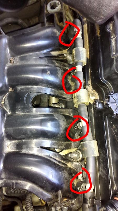

Ok, I took out the airbox and took a picture of where the hose goes. Hope this helps

Yes that probably is the case. I live in WI and I had issues with the car in cold weather, so I know they put a different style intake in that "was made for cold weather"...
