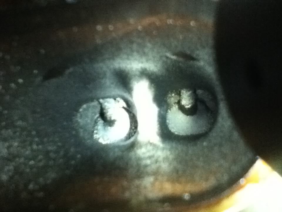

So here's the proff that Sea Foam works. I replaced the intake manifold this weekend with the redesigned R56 intake manifold for the 2007-2010 MINIs. Here are the pictures of my intake valves:
I forwarded these pictures to the dealer and they were surprised at to how clean they were. I have probably done the Sea Foam treatment about 15 times since October 2009.
My MINI has over 63,000 miles on it.

It looks like you've got some buildup in there, but much less than I'd expect to see at 60k+ miles. How many miles did you have on it before doing any seafoam treatments? I suspect what you show and what I've shown work to confirm what some have theorized in here; that seafoam will do very little to remove caked on carbon, but starting early and doing treatments often is where it would help.

I started at about 37K miles. With the newly designed intake manifold you can inject Sea Foam or any other cleaner right into the intake ports. This should make any cleaning a lot more effective.
After getting the MINI back together and running I slowly induced carburetor/choke cleaner directly into the intake ports on the head for about 5 minutes. I suspect whatever buildup remained was greatly reduced.
