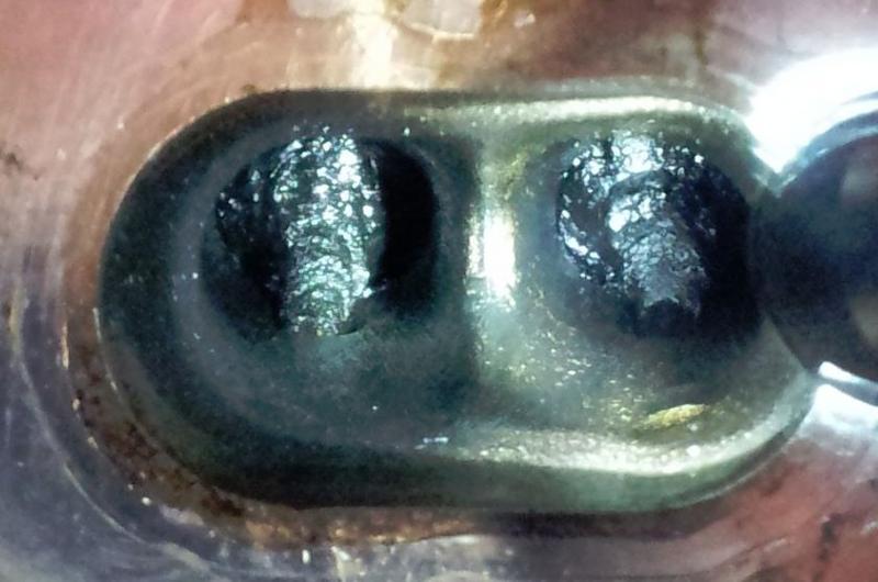

Old Jan 1, 2012 | 10:10 PM
  #156
Hoopty's Avatar
Hoopty
Joined: Dec 2007
Posts: 133
From: Mission Viejo, CA
Update: 17k Miles Later……..
My car had 40k miles in the first cleaning (OP) and now it is at 57k miles. For the last couple months my car has been stumbling and running rough, especially in the morning. It was running very much like when the HPFP was going out, so I thought maybe it is going out again. I tried changing the plugs but that didn’t make any improvement. So I figured maybe it needed another scrubbing by hand with SeaFoam. Well I was right…..the pictures tell the whole story. But the results are fantastic, it now runs like it is brand new. Because it slowly gets worse every day you just don’t notice the performance reduction day to day. Your boost gauge may be reading full boost but it is not flowing past the valves with all that gunk on them. The performance improvement is huge….I got all the wheel spin back that had slowly faded away.
Hoopty
Attached Thumbnails Picture Of My Valves......Before SeaFoam-valves-1.jpg   Picture Of My Valves......Before SeaFoam-valves-2.jpg   Picture Of My Valves......Before SeaFoam-valves-3.jpg

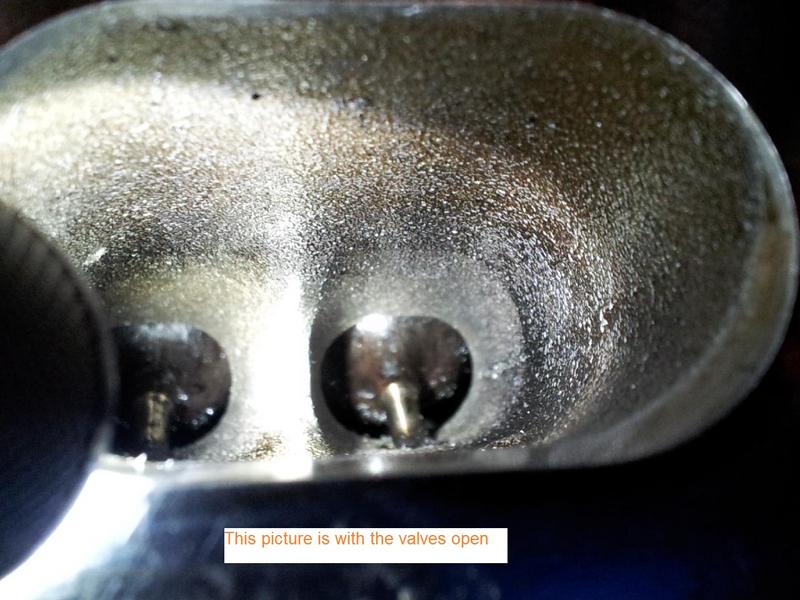

Old Jan 1, 2012 | 10:35 PM
  #157
Hoopty's Avatar
Hoopty
Joined: Dec 2007
Posts: 133
More Pics......
More Pics......
Attached Thumbnails Picture Of My Valves......Before SeaFoam-valves-4.jpg   Picture Of My Valves......Before SeaFoam-valves-5.jpg   Picture Of My Valves......Before SeaFoam-valves-6.jpg

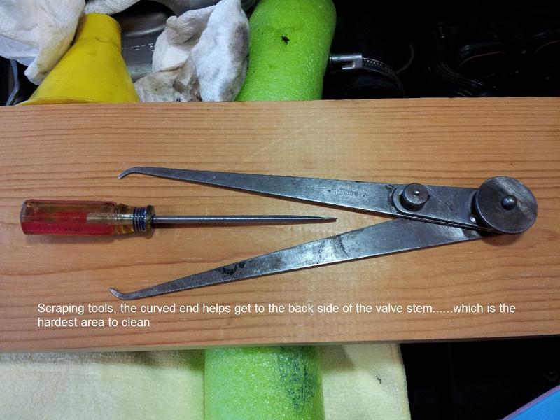

Old Jan 1, 2012 | 10:50 PM
  #158
Hoopty's Avatar
Hoopty
Joined: Dec 2007
Posts: 133
Couple More Pics........
Attached Thumbnails Picture Of My Valves......Before SeaFoam-valves-7.jpg   Picture Of My Valves......Before SeaFoam-valves-8.jpg
