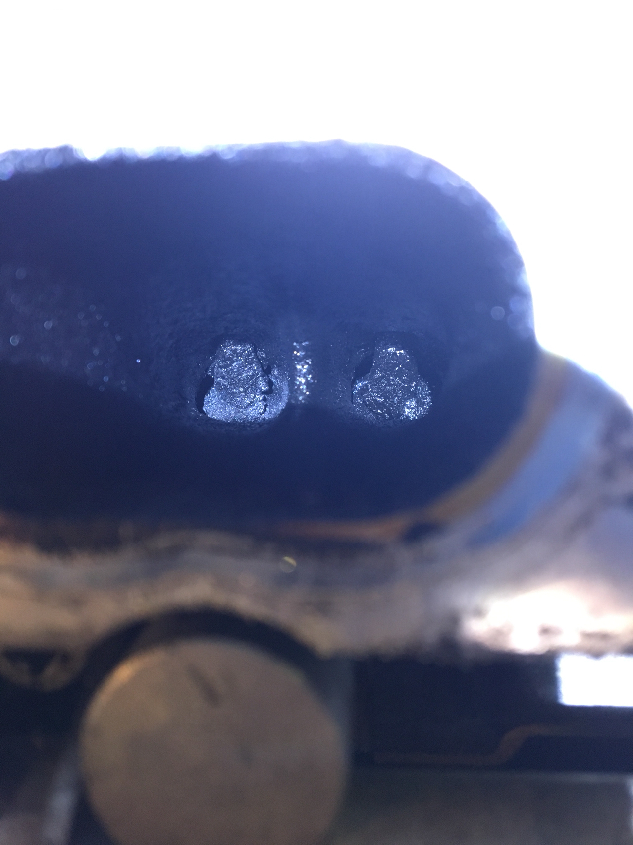

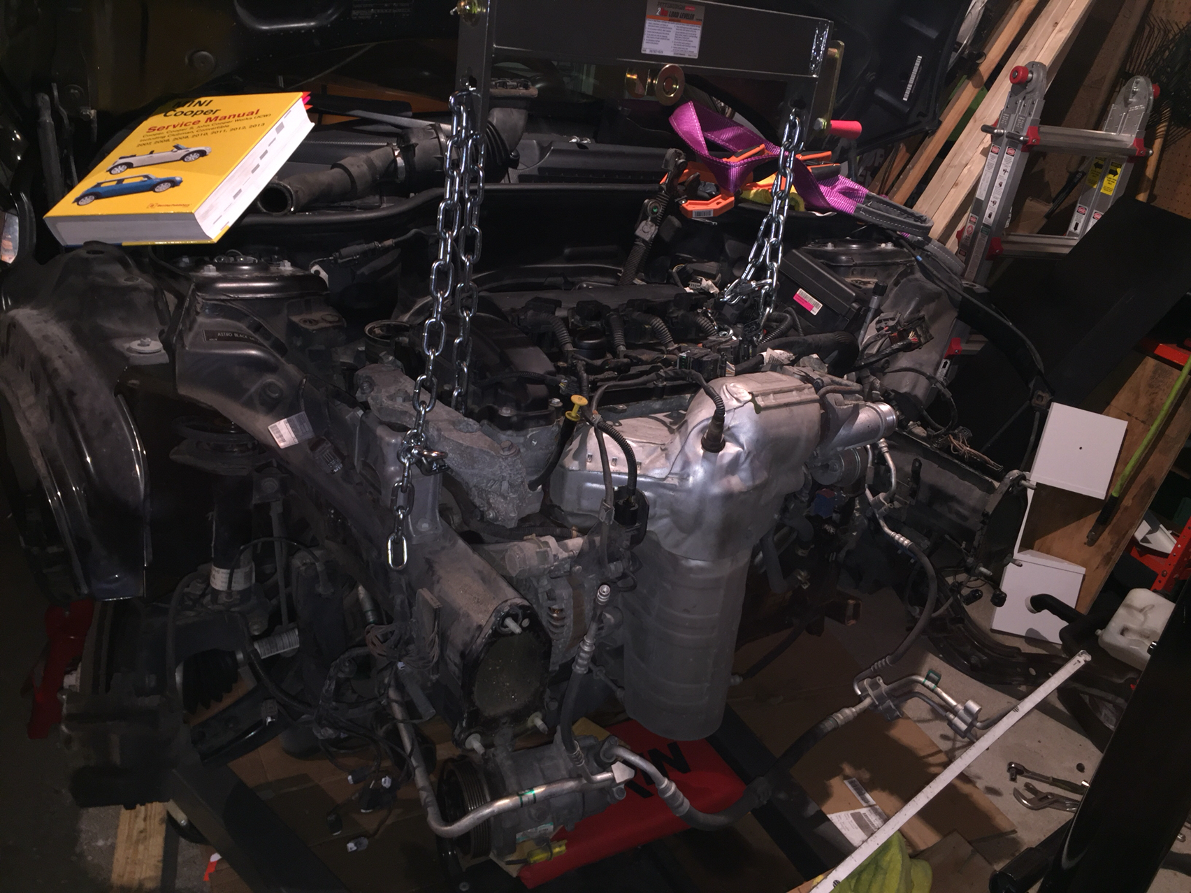

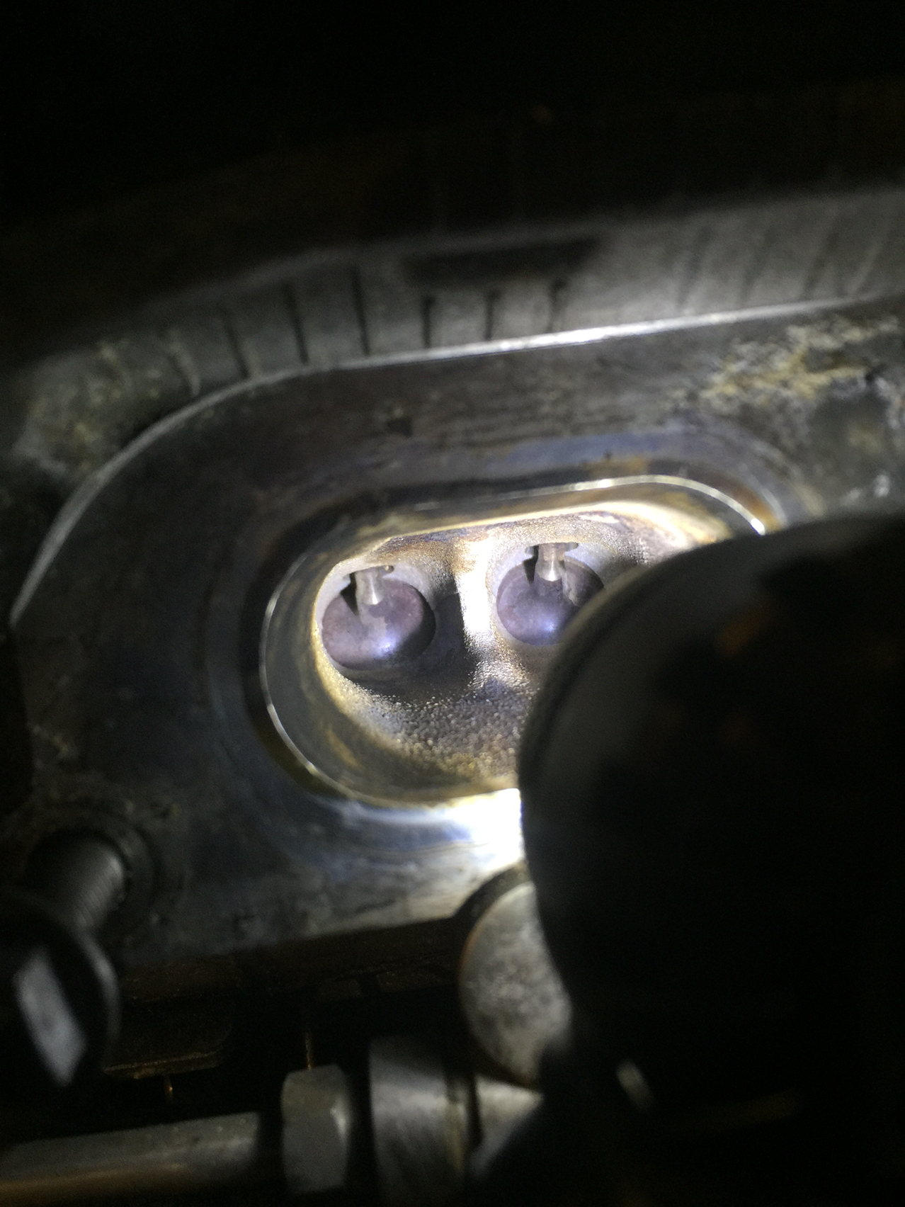

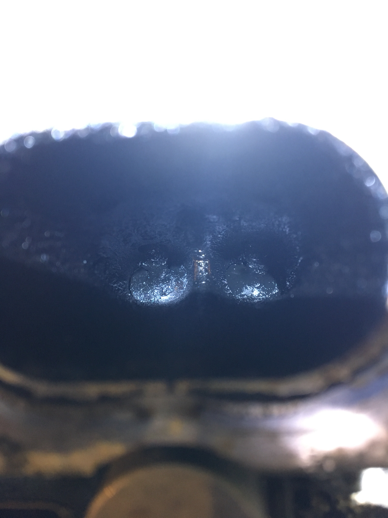

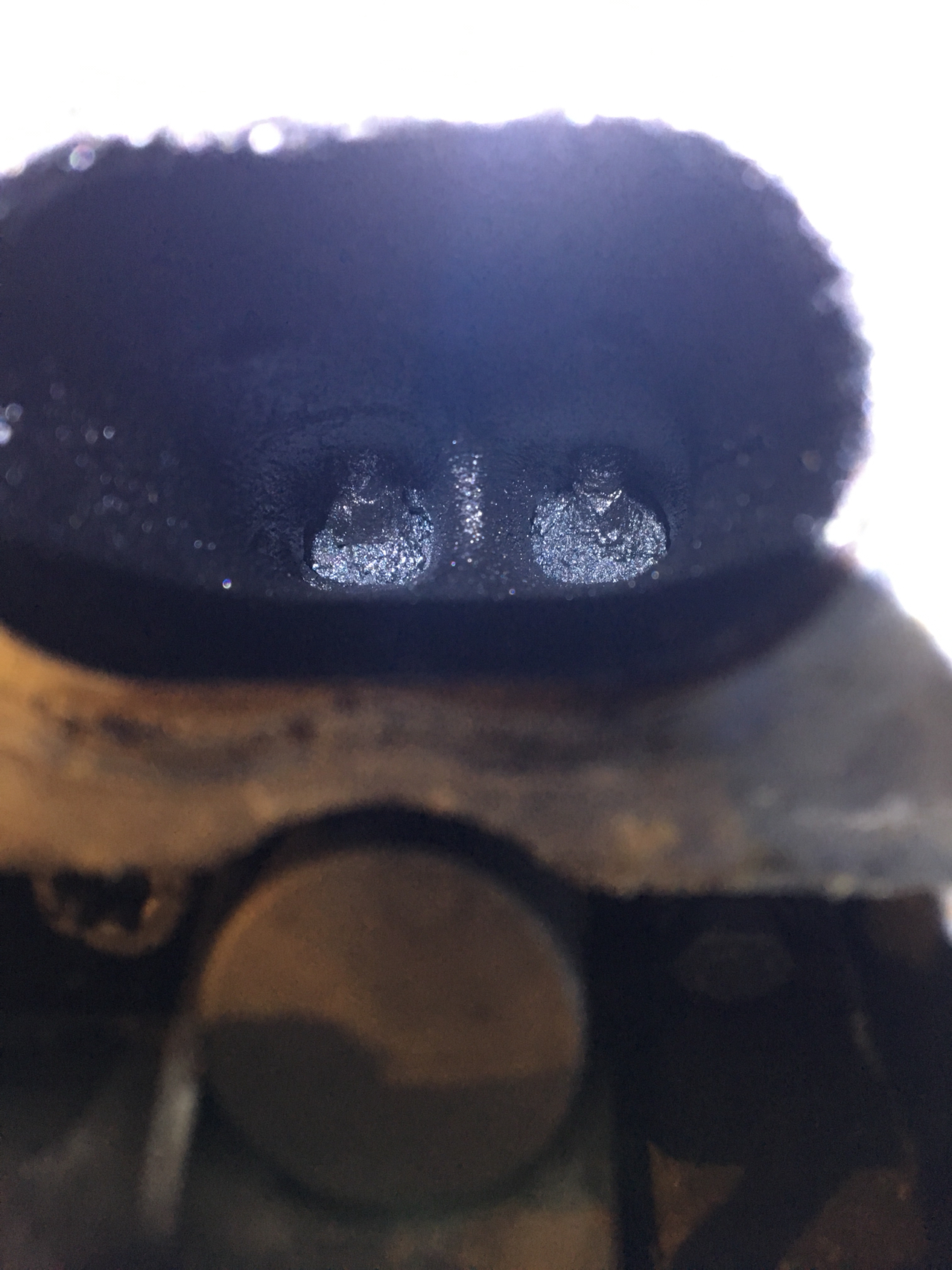

I have a 2009 MCS with 212,000 on the body and about 160,000 on the engine.
Pulled the engine because I have a long list of things to do. Numerous oil leaks.....thermostat....timing chain, etc.
Take a look at the carbon!!!
One of the worst I have seen.
Now I have to figure out how I'm going to know when the intake valves are truly closed.
Have all the tools for walnut blasting.
I'm sure I will have a difficult time getting it all removed.
When removing the intake manifold I didn't expect to see the inside of the chamber so wet with oil. Installing a OCC as well. Is this normal?

Sorry if the questions sound like they are coming from a nube....which I am not. Ha.
I didn't expect the entire intake chamber to be so wet with oil.
The plan is turn the engine over by hand and watch the valves come up and seal. I just wish I knew by looking at the cam if the valves are closed for sure. Why don't they just simply place timing marks on the components like Honda does? So much easier. There is a ton of carbon on the intake valves so looking at them doesn't really help. I guess I will watch them go up and if it looks correct spray a little carb cleaner and make sure it pools up in the chamber.

I sprayed carb cleaner in mine and let it set for 5-10 minutes. The two center valve will be closed at the same time and vice versa.

I have a couple of things you might try. With the spark plugs out, you might see if blowing LP air in the cylinder leaks out the valves. Also, you could let some cleaner pool on top of the valves for 15-20 minutes and see if it leaks out down to the cylinder head (Which you could vacuum out or let evaporate).
That's my two cents'. You may have already thought of these.

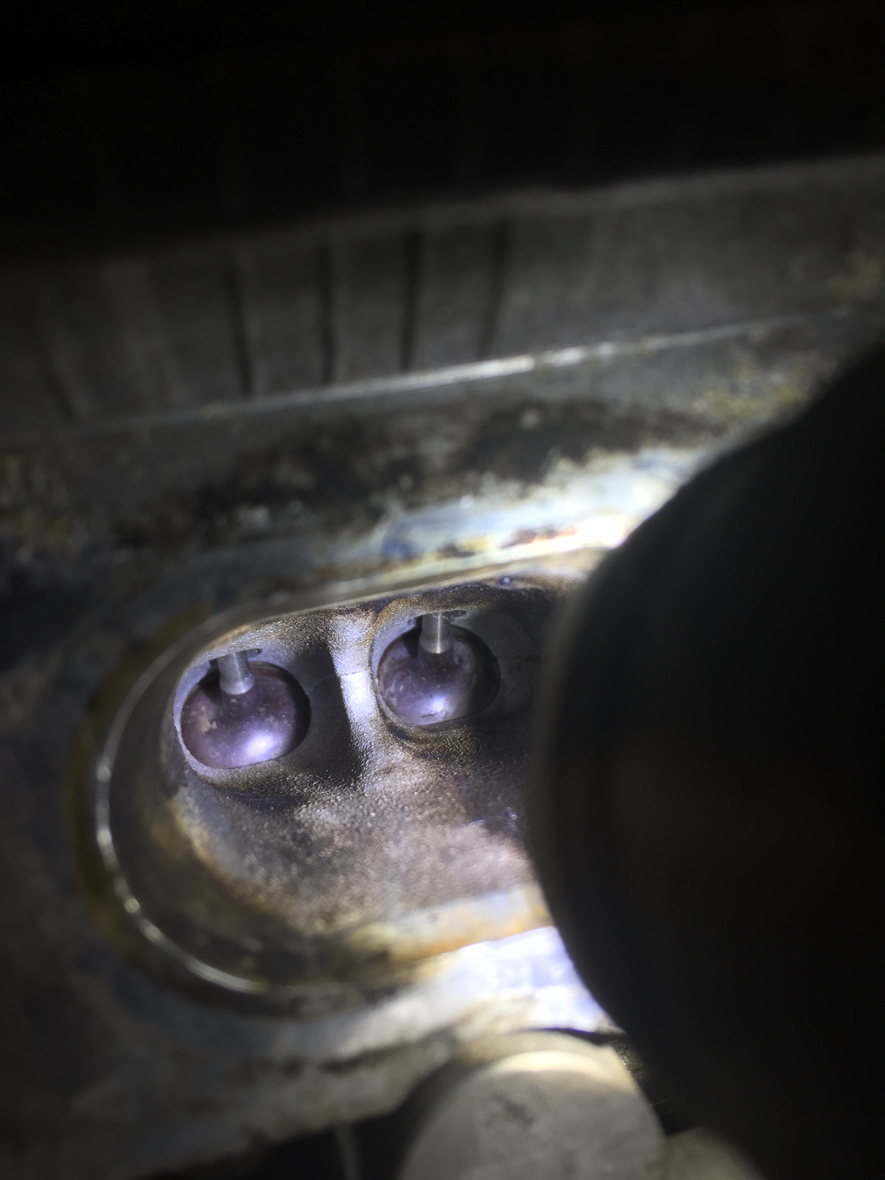

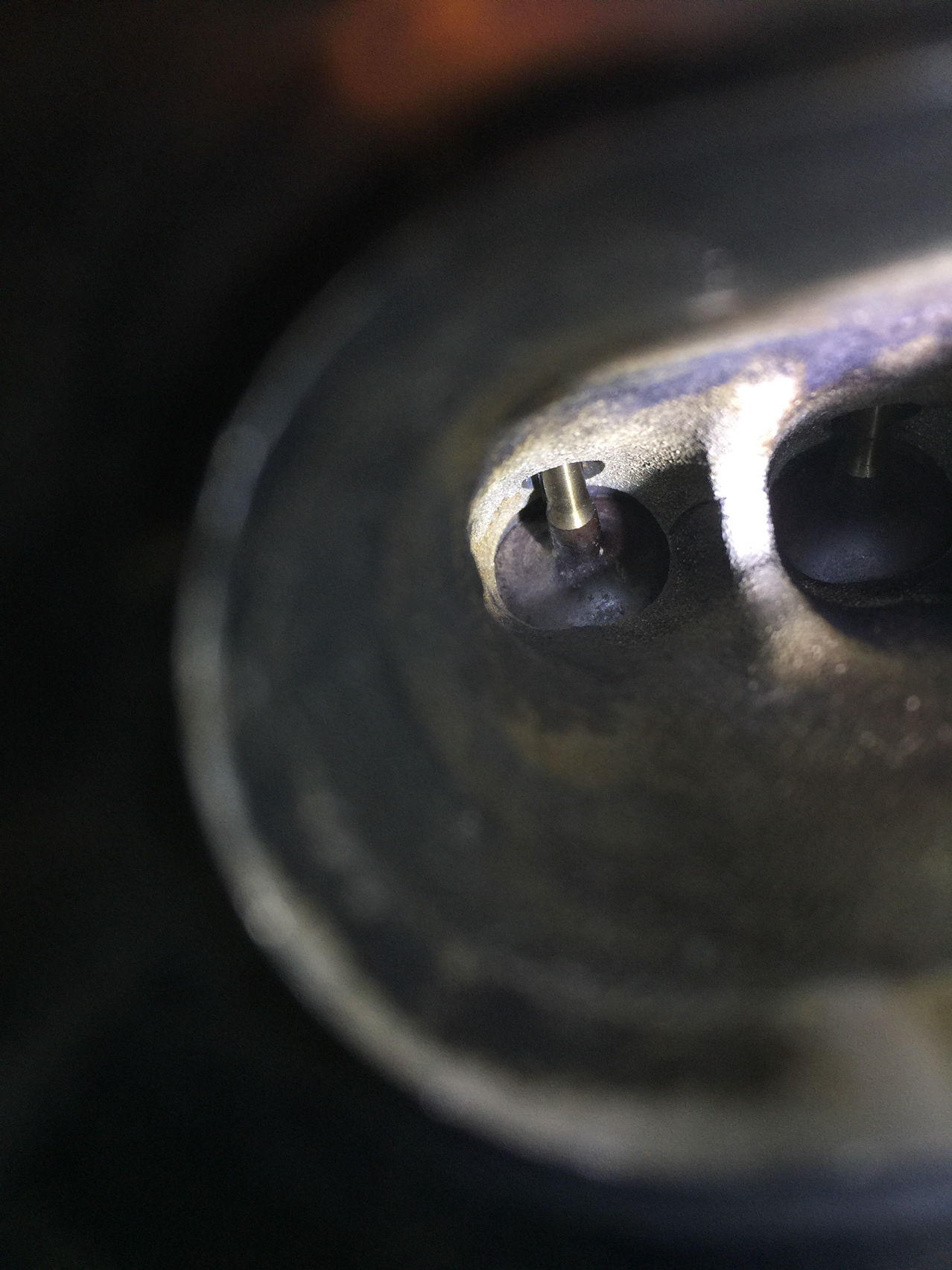

After pics.
2 center cylinders are closed together.
Sprayed carb cleaner....it pooled up and verified they were closed. Blasted with walnut shells and bye bye carbon.

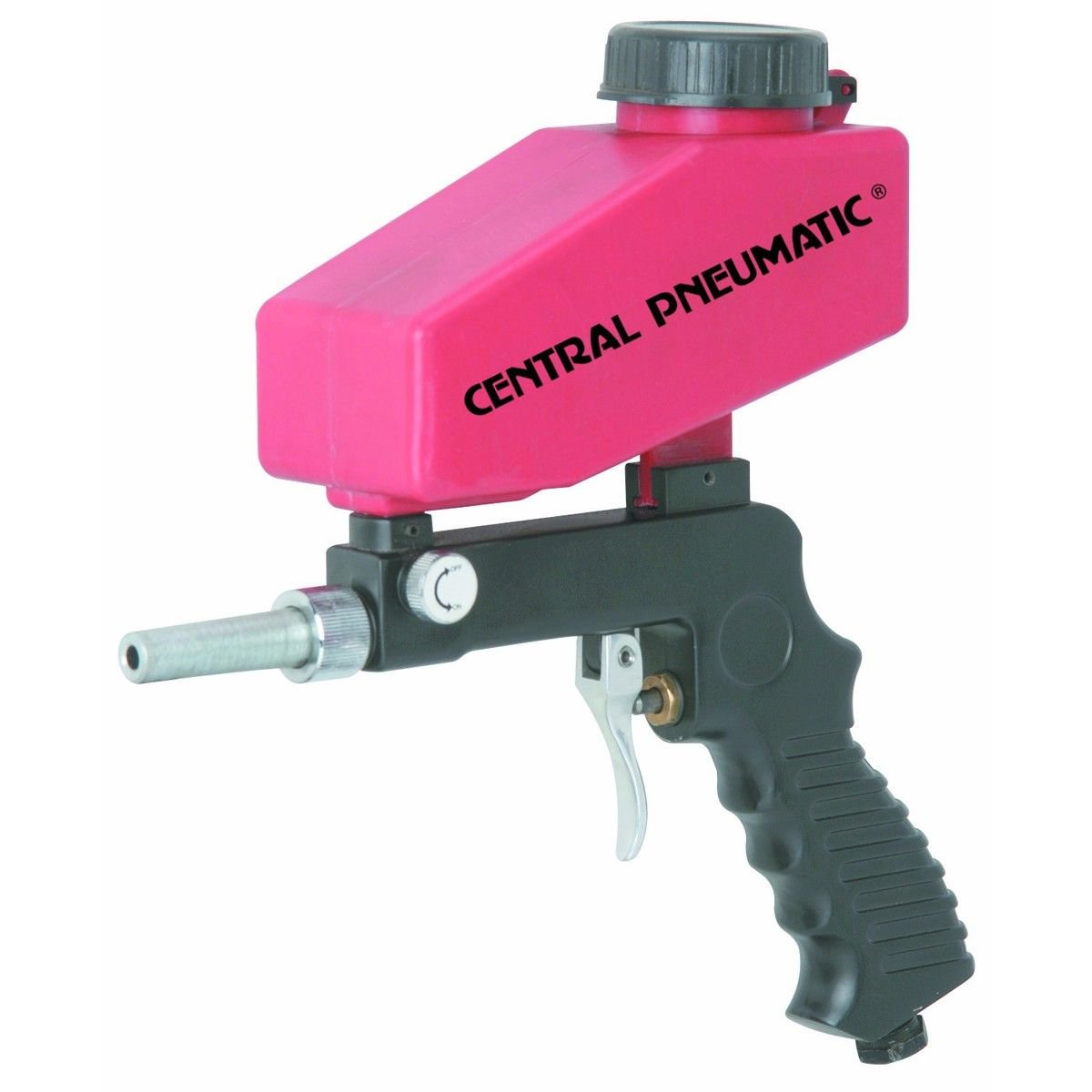

Can you show your walnut blaster? I going to take my engine out also, change out clutch, timing chain, waterpump and check the valves. If I need to walnut clean was thinking of using a harbor freight blaster, not sure if that will work.

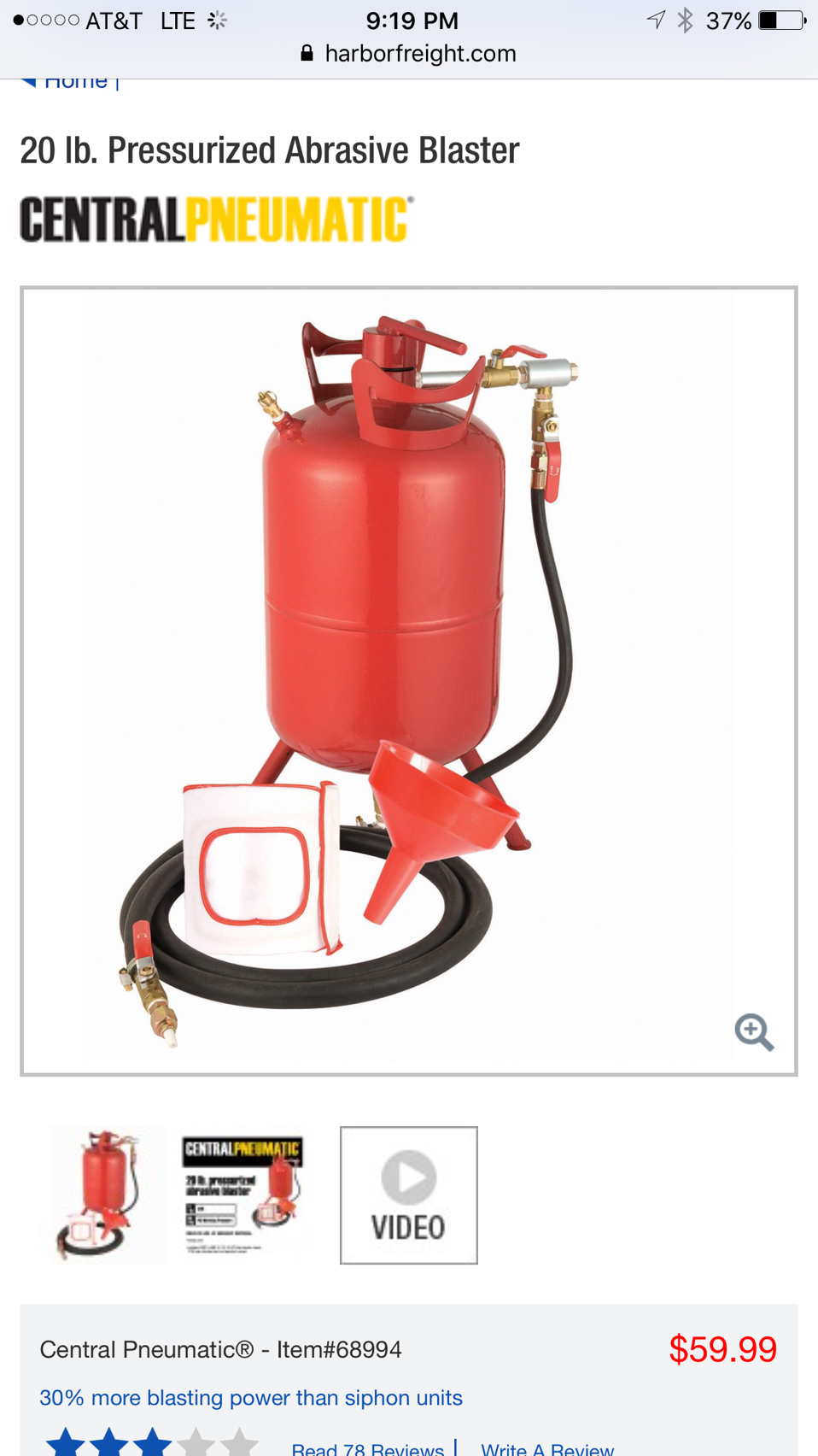

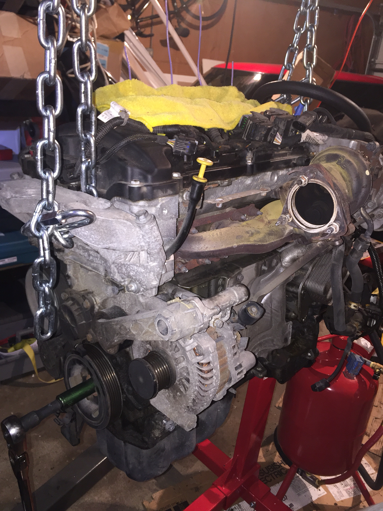

Sorry not the best pic but it's the 20 lb media blaster from HF. Seen in the bottom of the pic.
My air compressor is a Quincy 20 gallon seen in the other pic.
I'm using the BWM/MINI OEM wand and manifold adapter and HF walnut shells.

Pics

I was thinking small, think this will work or just go big or go home?
Old May 13, 2017 | 07:47 PM
timski's Avatar
timski
Joined: Feb 2015
Posts: 320
Well, I think you will be refilling that gun like every 2 mins. I had a really hard time controlling the flow of walnut shells. My setup was throwing a ton of shells. No matter what valve I adjusted I just couldn't slow it down. I ran at 90 psi. I think lower psi might have been better. I cleaned out my vacuum before starting and just reused the 5 lb of shells over and over. I did the whole job in about 30 mins. You need to find a setup that works for you. If you are under-powered in any way you might not be able to even start. Good luck.
