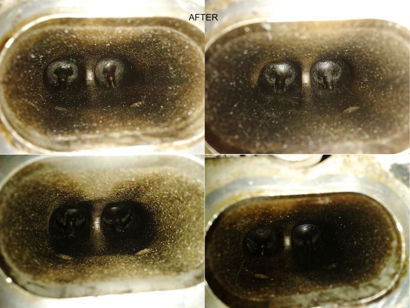

I finally cleaned them. It is not difficult but I have to say it was a pain in the A%$ to remove the manifold. Especially the hoses. It was impossible to remove them. And their clamps were in positions which it was very difficult to loosen them. I scratched my hands everywhere. It was like i have been attacked from a cat! Also if you are kind of tall (1.85m) be ready for some knee pain! It took me from 13.00 to 19.00 and the first 2-3 hours were to get the manifold out. It took me 30minutes to put it back.
I followed this guide https://www.northamericanmotoring.co...right-way.html , which has an error, there is also a 10mm bold under the manifold, beside the large intake hose, if you want to remove it completely.
I used a baby's toothbrush, and a screwdriver with a cloth to clean them, but a thin and long brush for cleaning the barrel of guns, which i didnt have, will be very helpful. and also a good flashlight! An air compressor is a must!
I have taken some before/after pics of the valves. The car has 40000miles (2008 model), and i use 98oct gas, change oil every 3000 miles.
