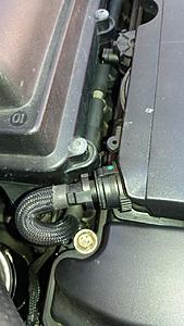

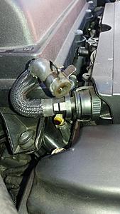

My car is a 2009 R55 Clubman S 102500K miles
This may seem obvious but just need some confirmation. After replacing the air filter this code came up: Pressure Control Deviation 2885, and the car went into limp mode. After I checked out where I was working on the car I noticed that the line to the PCV was cracked right off. The rest of the piece is stuck in the hose. I must have broken it off and not realized it. When monitoring boost and vacuum I noticed that at idle vacuum was 15 in/HG instead of 22,23 in/HG. My Boost is 1.0 psi. So the question is, would this line being cracked and broken off cause the Control Pressure Deviation 2885 Code? Also what is the part called that the hose attaches to?
Thanks,
Frank

The vent hose on your car does not look original. It should be just a hard plastic line covered with an antiabrasion sleeve and connects the valve cover to the intake manifold.
http://www.realoem.com/bmw/enUS/show...diagId=11_3915
Maybe you have an OCC installed?

Nope, his is original. That is the set up referred to as the “cold weather manifold”.
https://www.ecstuning.com/b-genuine-...n/11614584240/

Yep thats the cold climate version that is now nla.

Thanks to all who identified the part for me. I think bugeye1031 was the first person but it didn't dawn on me until everyone else chimed in. Yes the intake was replaced around 55K. I bought this car from my friend and have all the service records. I remember reading about the intake and shaking my head thinking how does water get in the intake. Anyway it was replaced and while it was off they walnut blasted the intake valves.
So now the question is: How important is it to replace that broken part. Pelican Parts has the manifold for $35. The car is running excellent. Not sure I want to mess with it. What is the car not doing by having this piece being broken. I have put the line back on. It's just not airtight. Can I cover the openings up?
Thanks,
Frank

I'd take this as an opportunity to install an oil catch can between the outlet from the valve cover and the inlet to the manifold.
The reason for the cold weather manifold is water vapor from the pcv system condenses in the throttle body and can build up and freeze.

Do I need to worry about the broken part from the PCV hose to the PCV rail?

ECS sells the block off plugs. Install these whenever you install the catch can.

Yep, info here on the Genuine MINI Block off plug mod https://www.northamericanmotoring.co...-question.html

Not sure where you are with this Frank, but as long as the connection from the valve cover to the intake manifold is leak-free, then you're okay.
Did you decide to install an OCC?
