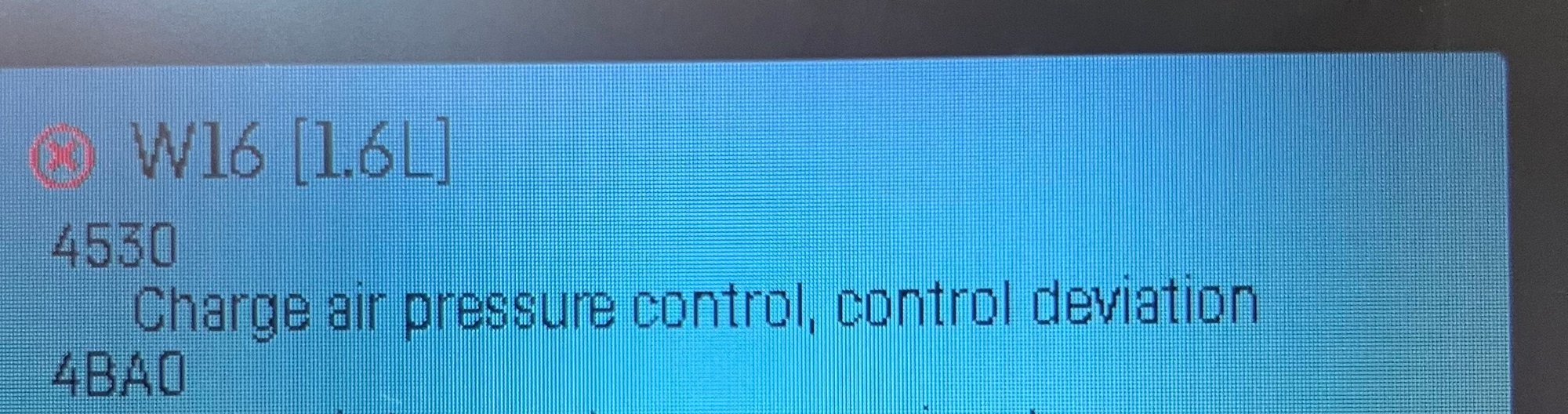

Help no boost Line missing
Hi my car is not getting any boost im missing one line from vacum solenoid i checked all hoses from small black box behind the engine and all lines are good my car was running very good but it sudenly stopped i cant find where this ATM line is missing and the car has 0 power but its not in limp mode my car diagnostic tool says charge air pressure control deviation i checked the turbo everything is fine MAP is good everything is good helpp
