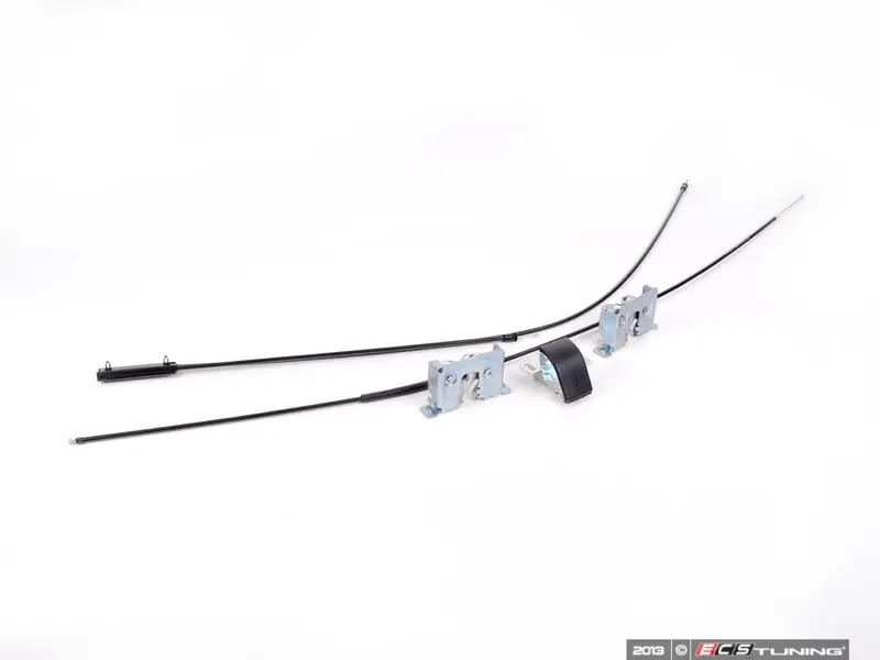

Yep, they can rust at the front or get gummed up. Also the that handle can bend due to the stuck cables.
https://www.northamericanmotoring.co...atch-talk.html
Hit the front cables with some WD 40 once in a while and that latch.
URO now has a upgraded metal handle.
https://www.ecstuning.com/Search/Sit...h/51237149591/
