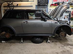

Figuring we'd start with the brakes, I got the car up into a friend's garage and let him do some troubleshooting with a pressure bleeder:

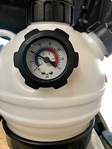

The first test was to place the pressure bleeder on the fluid reservoir, crank it up to 20 PSI, and leave it set overnight. The hope here was to either see a reduction in bleeder pressure or see fluid leaking from somewhere. The results were...well, not what I'd anticipated:
Very slight reduction in pressure, and no visible leaks anywhere at all. Grabbing a front rotor and attempting to give it a turn showed the braking system to be under sufficient pressure as well, not just the fluid reservoir. Very odd.

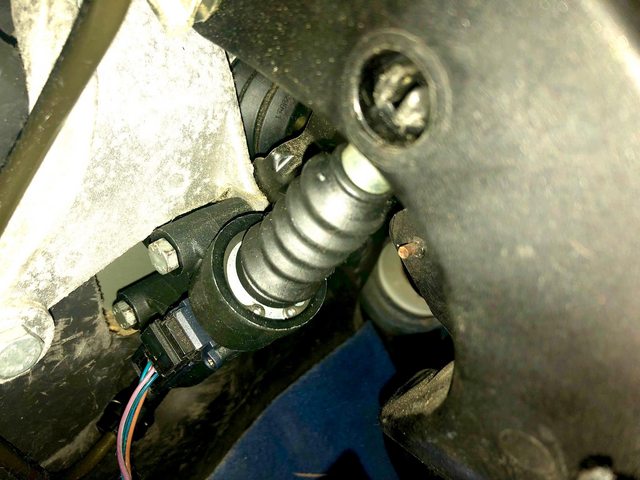

Haven't gotten around to fully rebleeding the clutch yet. Rigged up my piston compression tool and gave it a couple tries under pressure from the bleeder, but it's tough to see if any air is coming out - the fluid just sprays out at great velocity and in great quantity. I think next time I give it a go I'll put my bleeding tube/bag on the thing so I can see if any air is escaping.

However, there's still some kind of issue with the clutch. I'd compressed the clutch slave piston with the "MOD Mini" method and once again bled the system, this time with the speed-bleeding tube/bag on the bleeder to be able to see any air escaping. Got nothing but clear fluid, so I removed my "compression tool" and reinstalled the clutch slave. There was still 1-2" of blank pedal travel at the top of the range that I don't remember being there before, but the clutch seemed to be disengaging fine and the car would go into all of the gears. Put the car back together and took it on a test run and the car drove fine, but the clutch still didn't seem "right". Very spongy pedal feel.
I left the car sitting for a couple days while I went out of town. Coming back to it, the clutch has somehow worked itself to a non-functioning state - lots of loose pedal travel at the top and the clutch is not disengaging again. Putting the bleeder back on the clutch slave and re-bleeding brings only clear fluid and a minimal change in pedal feel. Once again, there's no discernable leaking in the system anywhere. Considering the entire clutch hydraulic system only has two parts and one of them (the slave) is brand new, the only thing left to be faulty should be the clutch master cylinder - but that looks fine too:
