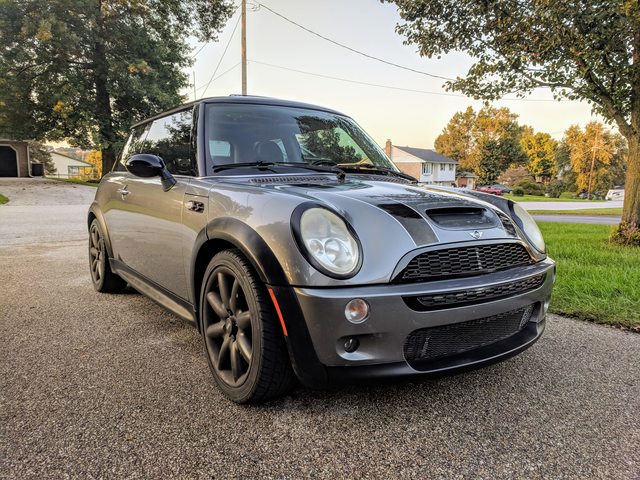

I've got a 2003 Mini R53 (build date 01/03). Here's an older pic; it's on a set of Clubman spoolers now:

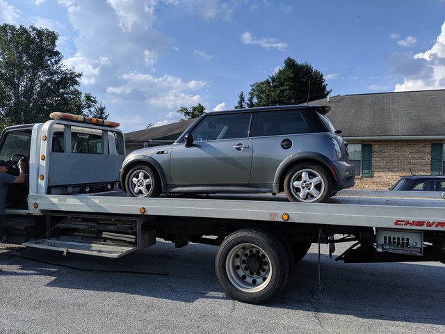

The "Mini specialist" shop was...well, let's just say it was an adventure. For brevity's sake (since this is already becoming a wall of text) I'll give the TL;DR version - they said my brake fluid reservoir was cracked so they couldn't pressure bleed the system (though I'd never noticed any leaking from there), so I ordered a replacement myself, dropped it off, and had them install it. They then said they were able to bleed the clutch, the brakes were still slowly bleeding down, however the car was "driveable," and my bill was $400. They recommended I get a new ABS module and quoted me $130 for a used module and another $700 for labor. At this point I told them to go pound sand and went to pick up my car. Brakes go straight to the floor and the clutch is back to the "two inches of free travel, then mushy firmness" status (but it *does* go into gear, albeit unhappily); not the "driveable" status they told me it was. Had it towed again, and that's where we stand now.
So, after $500 and three weeks' time I've gone from "driveable but getting sketchy" to "completely undriveable." Kinda moving in the opposite direction than intended.
