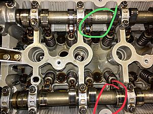

He can line up the camshafts so that the numbers all line up pointing upwards. But the intake one has like a little bit left of the turn that it can still go (but the chain doesn't move when he adjusts). He can adjust them so they line up. Get everything running and when he turns it off and opens it up again, the rear one has slipped back down and forwards that same quarter turn. You can see in the picture. The red stayed up but the green one is lower. When this happens, the intake bolt is loose.

First of all don’t use vice grips on the cams like that. You are creating a spot for the cam to shear and making metal shavings.
Are you using the Vanos dummy plug torques to like 5 nm (3 pounds)? I can’t remember but it’s really really low. If it is too tight it will do exactly what you are seeing.
During my first attempt I did not get the vanos seated correctly and the bolt loosened up. Make sure it is perpendicular to the intake and seated correctly when torqued.

Here's a link to a very detailed cam replacement procedure, for my '07 MCS --- https://www.newtis.info/tisv2/a/en/r...aft/1VnY7d2Xnh --- It includes all the info you need to set / adjust timing. Note that the vanos dummy plug torque spec is 0.6Nm which equates to about 5 INCH pounds --- much less than most small torque wrenches go to. Chances are, you've been tightening it too much, like jjcsnlynn suggested, causing all the grief. It's really important that things be installed and tightened as described in the procedure. And, just to be sure you use the correct procedure, go to the newtis home page and enter the last seven characters of your VIN --- just in case the '07 procedure is different from the '10.

I never thanked you. He was missing one step, the locking the cam bit. All good now! On to other problems. Thank you!
