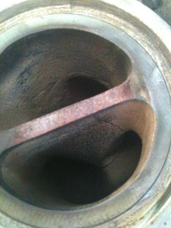

Now, i know this will be hard for some to believe but it happened to me. I also state that I have all the data and photos etc to back up my writings.
So, here it goes...
My 2007 MCS bought new in 12/2007.After 17000miles it had a cracked turbo and manifold indeed being stock.
Then, after having fitted some tuning parts (Jcw tuning kit,DP,IC,boost tubes,Ecu tune) and altered the power to higher levels than stock, after exactly 17000miles another cracked manifold and turbo! The crack patterns are exactly the same as before.
After careful observation and comparing the S turbo to the JCW turbo, there seems to be a design error on both turbos that is causing the problem.
This combined with the super hot EGTs is eating up both the manifold and turbo and induces cracks due to flow restrictions inside the turbo! The JCW turbo though it has the same flow restriction as the S's turbo, it has thicker internal walls.
Added to that restriction, both the S and JCW turbo do not have a matching flange with exhaust manifold!
How bad is that together with the hot EGs? It induces gasses swirls and simply cooks the metals to destruction.
The color of the fried metal inside the turbo is snow-white!
This color indicates that it has been heated to a degree out of its designed purpose. But, hell, I just remembered having lower EGTs after the tune.
Both with stock and tuned configuration, the turbo deteriorated very very soon.
So, as far as I am concerned, unless the inner design of the turbos does not change, these turbos will simply explode one after the other. I, personally, will carefully machine the flanges and the inner section of my JCW turbo to match exactly the manifold and run even lower EGTs along with stock JCW boost pressure and hope this JCW turbo and manifold lasts more than 20000miles.

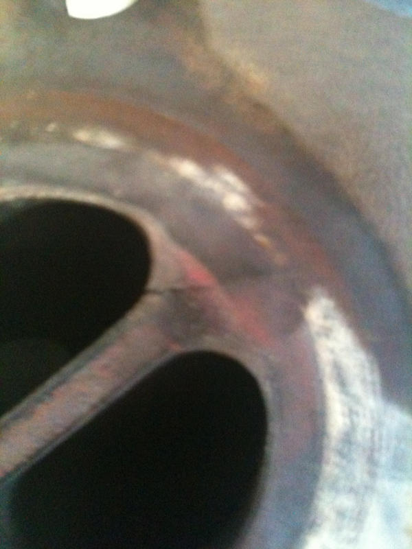

2007 S stock turbo + S stock exhaust manifold
These two (turbo and manifold) were fitted to my engine from the factory.
S turbo part number: 11657565912 up to 03/2010
Notice the cracks start from the side where 4-1 cylinders port are.
Again you can see the black surface (leaking gasses) from the 4-1 cylinders port.
S exhaust manifold part number: 11627574366 up to 08/2011
The cracks induced are from the 4-1 cylinders port side.

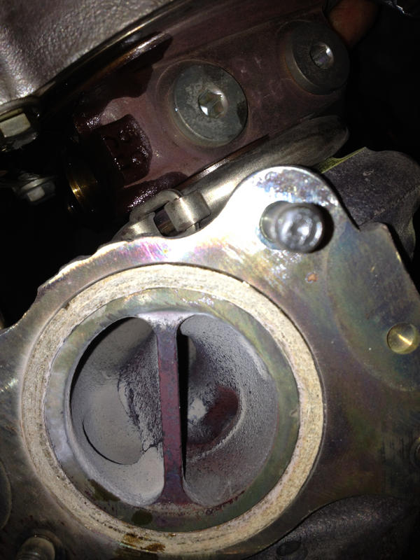

2010 S stock turbo + 2009 JCW stock exhaust manifold
S turbo part number: 11657600890 up today
Again, as you can see the same defective port. Notice the difference in colour between the 4-1 port and 2-3 port. This is caused by the flow restriction in the 4-1 cylinders turbo port.
