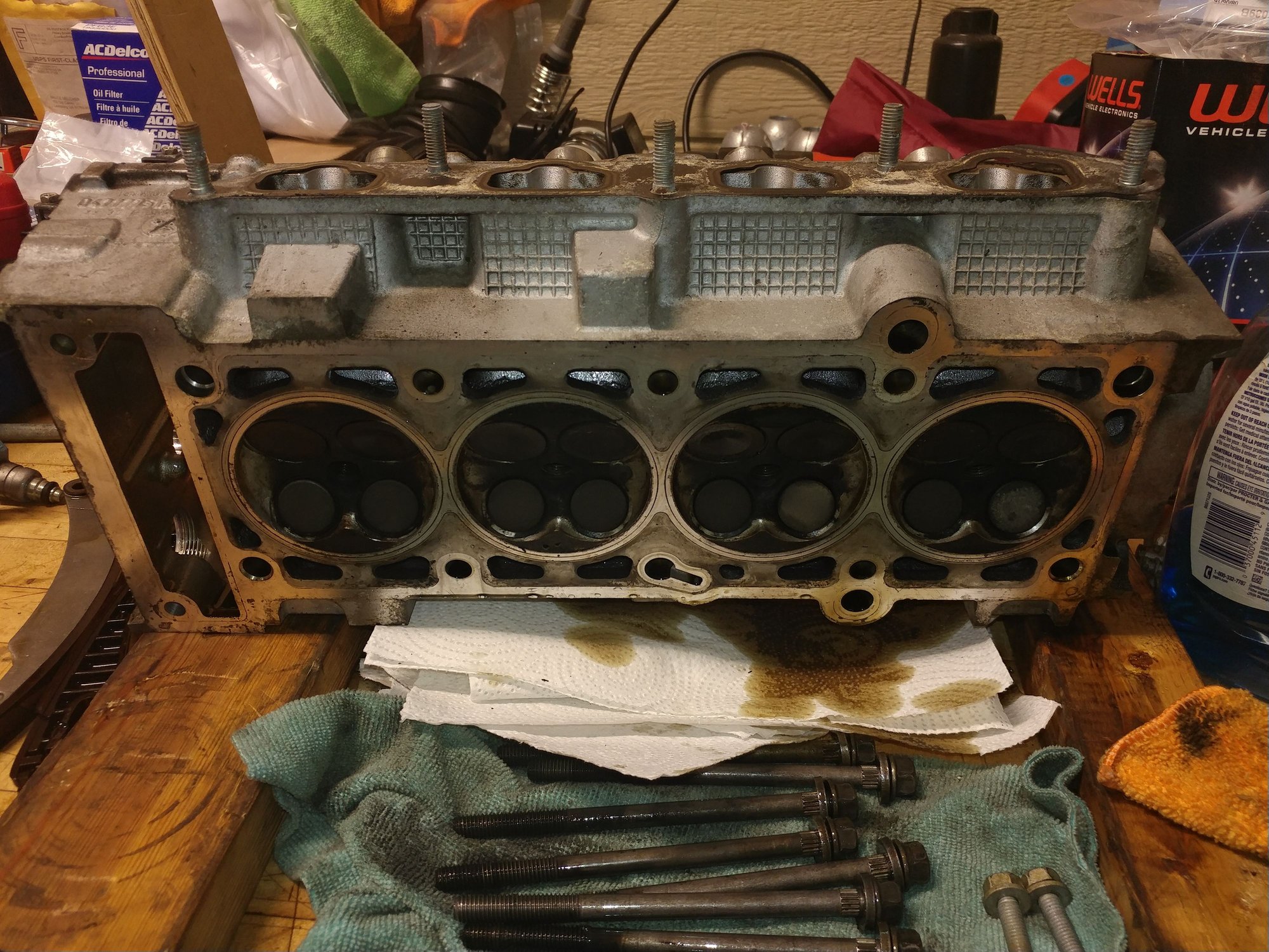

valves look ok, machine shop will know when they look at it. Head looks to have been rebuilt b4 so my moneys on bad install. Check out the markings next to casting number
cylinders were pretty clean so maybe blown HG.

I'm curious to know if you have any photos of the head showing the valves? I had to do a cylinder head swap and the valves that were burned on mine were discolored compared to the other valves. I'm curious if yours are showing the same effects.

David Baker - This is all I got. You can see exhaust valves in this pic. To me they look normal. As far as I know, Burnt, means burnt through. At that point, yes they should be discolored as they were subjected to higher heat than normal. Just my 2C.
Thanks for the photo. Looks like your burned valves are the discolored ones in cylinders 3 and 4. I bet if you remove those valves, there will be pitting and scoring on the valve seat. Not a terrible job, if I had the money at the time I did mine, I probably would've entertained a cam swap as well.
