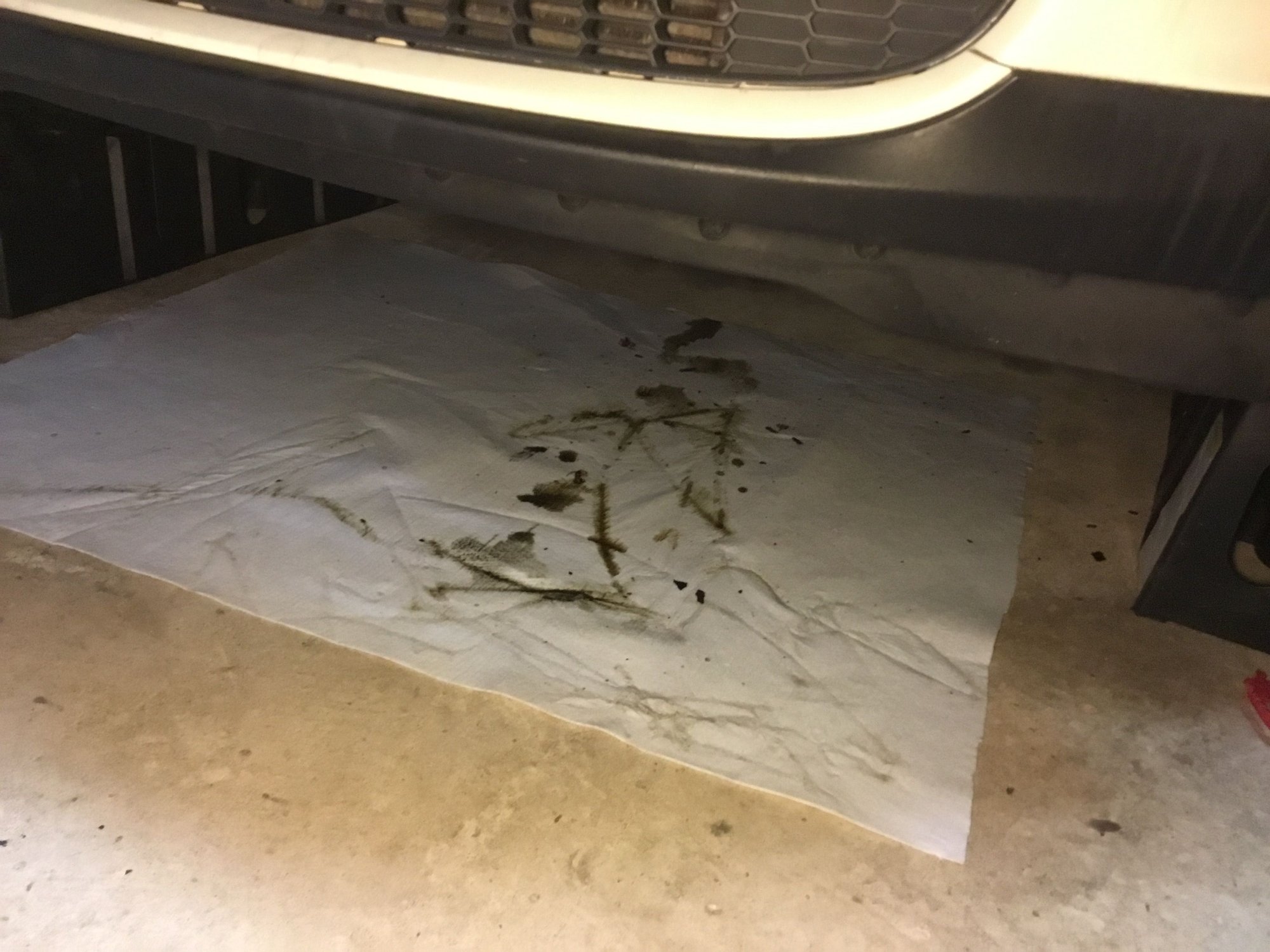

Hello guys.
I have a major oil leak I went to local dmv yesterday 3 miles away and red oil light flash at the dash. I stop check the oil level and is low. Add a 1 quart and find oil leak under the car, when I drive back home same story another quart . At home I remove some air lines and try to identify a leak and can’t find any . I get some oil between transsmission and engine. Oil leaks on driver side back of the engine , I remove manifold and is nothing wet .
I just replaced all turbo lines, thermostat gasket, HPFP, vacuum pump gasket, oil pan, valve cover gasket. I check all this dry. Anybody know if between transmission and engine any main seal gaskets?
