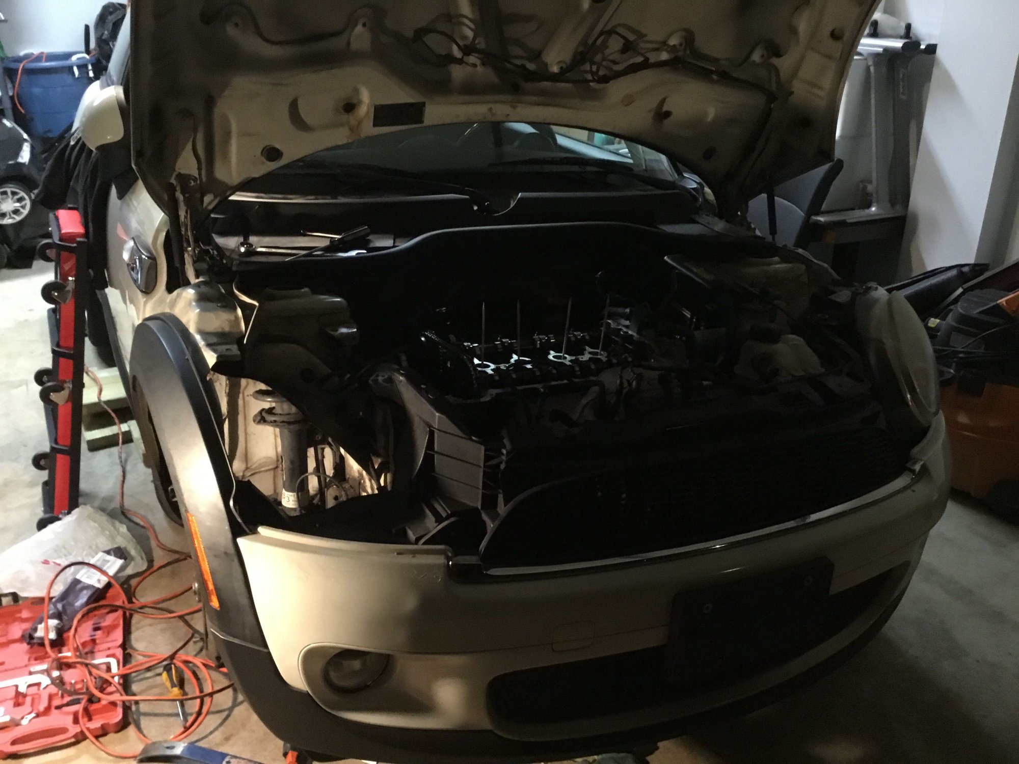

I order timing tool kit, borescope and chain kit. I put car in garage and start to take a part engine bay. Prepare for the timing job. After total inspection valve and cylinder head make final decision. Thanks

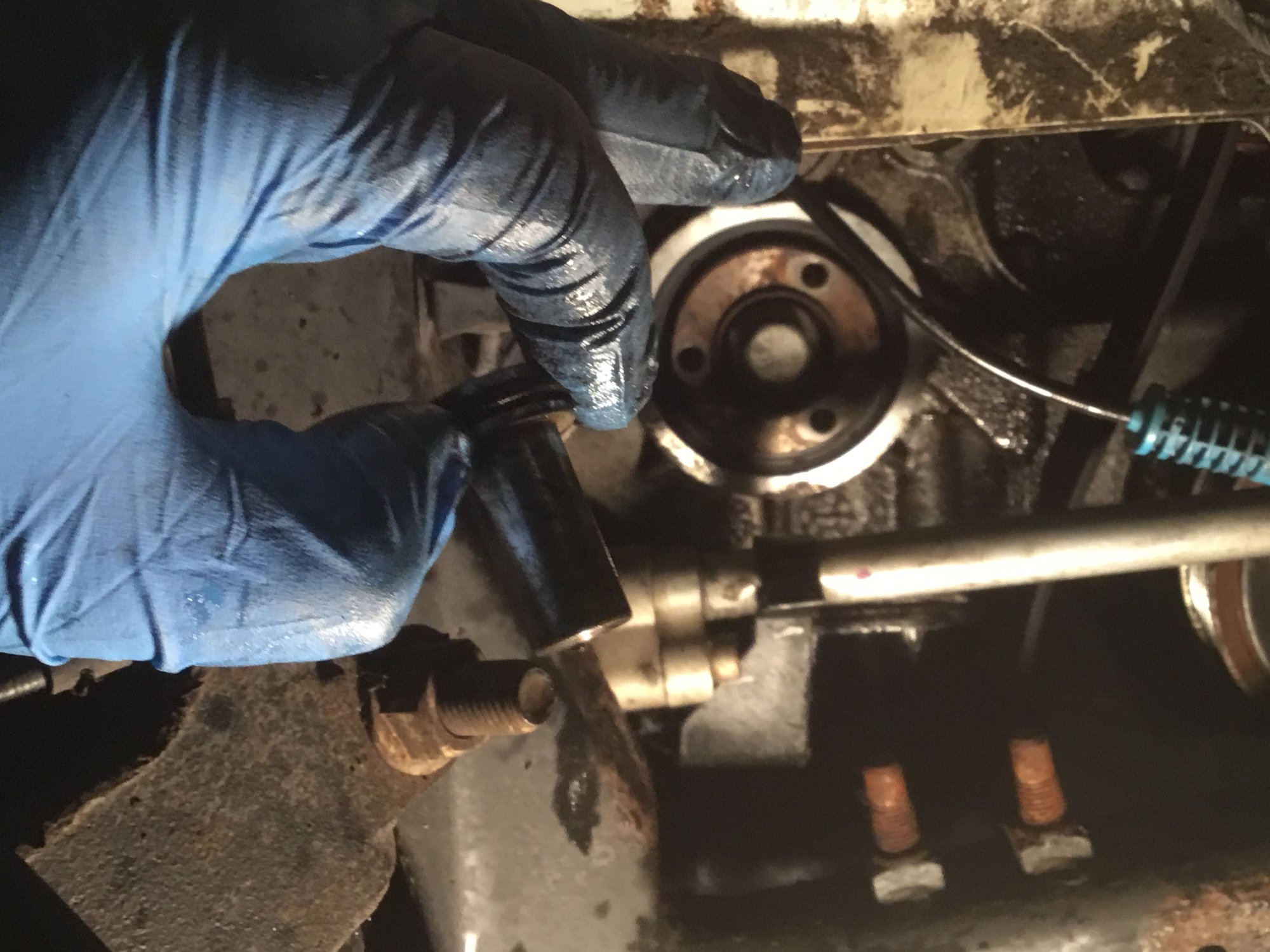

Hey Fox. I just got all my parts and tools together. Today I get all pistons strait and secure with locking tool. I got only exhaust valve timing correct and intake camashat not moving by chain. I also got lose main crankshaft bolt. For tomorrow I will take down engine support and time for chain replacement.

I have that locking tool...garbage...it wont fit unless you cut the "extra" end hitting the turbo. Also did you make sure the locking pin is ALL the in? I had to sand mine to make it fit!

I watch many different videos and everybody has same issue with lock tool. My lock key go in all the way from 3rd try. I can’t believe is so easy. I guess I’m lucky or just tool is good. I buy from ebay for $38 with delivery included.

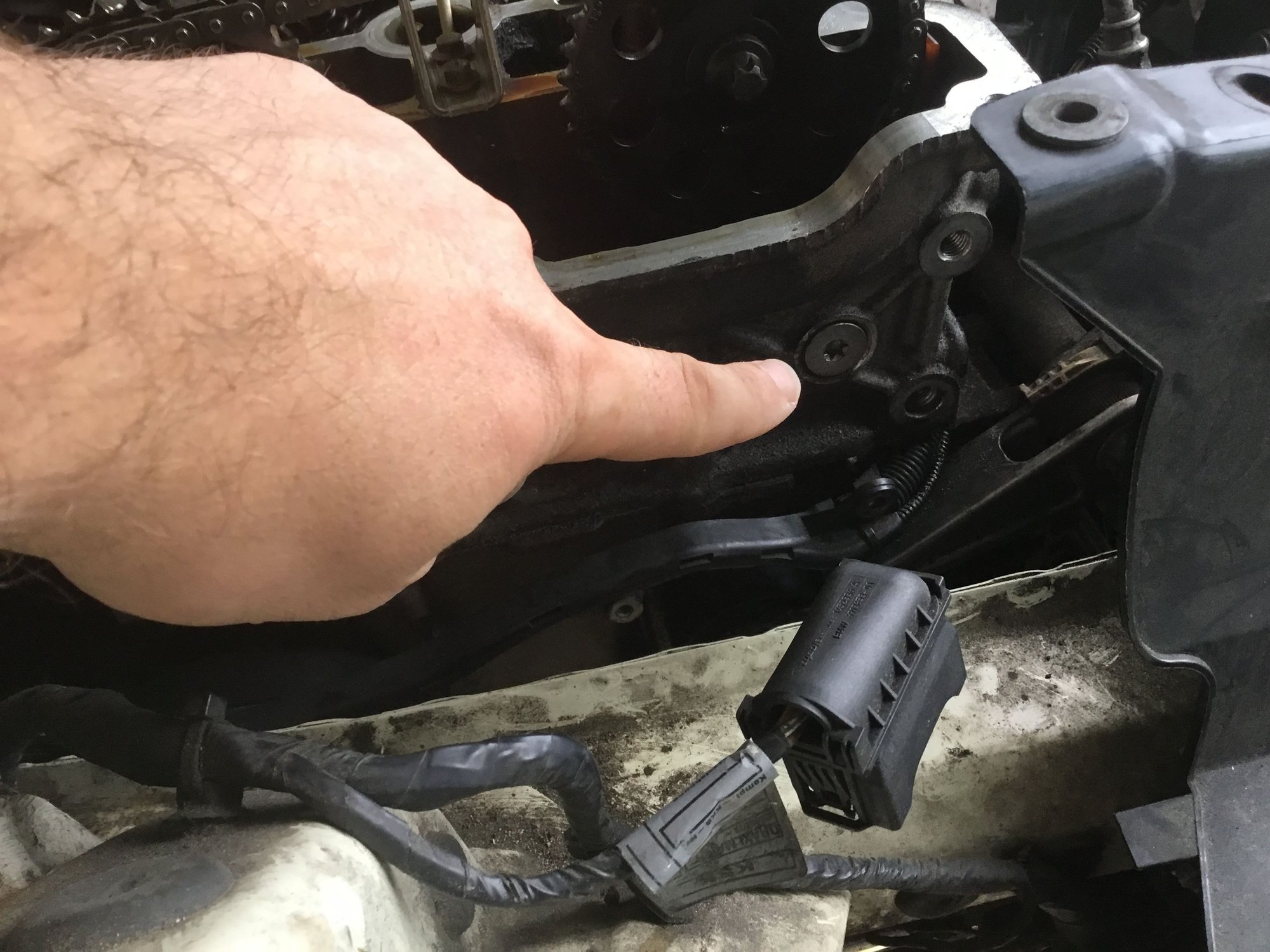

Hi everyone. Wow. Today I finally finish timing chain replacement. So let me start. I replaced new chain, tensenioners, guide bolts, gaskets on the valve cover and oil pan. Clean oil pump from small plastic debris and oil pan. I replaced camshaft seal and everiting on the way. Only difficulty what I get on the way is one 8mm bolt from oil pan right above exhaust pipe:( Rest of the stuff is easy. Only some how from first turn of camshaft my timing on exhaust mess up little bit. I adjust right away and everything great.
Ok I start car from first try and everything look fine. Well I warming up car and smoke came all around engine bay I guess this is just some oil etc. The smoke gone in 15 min and everything work fine. Car work great and engine pur pur like a kitty. I get on first drive and kick hard around 4000rpm to check and warming turbo. Everything fine till some moment I heard some noise from the side where is previously done chain work. I start investigate and what I see I can’t belibved. Lower right guide chain bolt is come off for like a 1in and seat on the belt and moving with belt?.. I like what ta hek. I put them all and tighten by specs in the book. So is no way is come off or untighten like this. I remove new belt and find out this guide bolt is broken a half. What I see is tred inside and half bolt in my hand :( I like OMG. So now I need again new tensioner bolt and some how remove old tred from the engine. Any ideas?

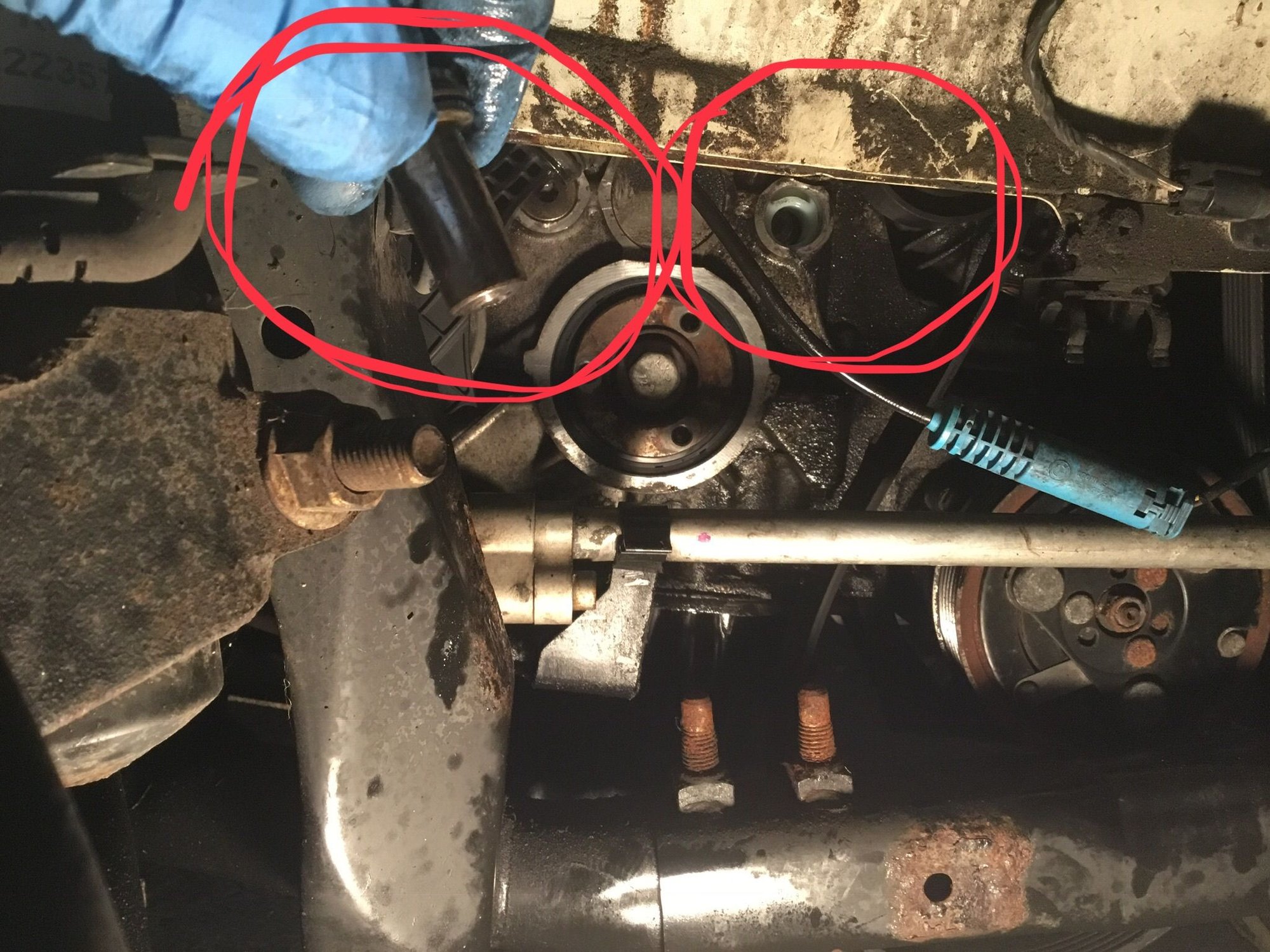

Also get some isssue to remove this Chain Guide Bolt first time , broke 2 heads:(

yeah, that bolt also gave me hard time...I have to hammer it out. I didnt care if it broke or not. you could tap on it to unfreeze it and use an impact wrench. also, make sure you torques everything to spec. https://www.newtis.info/tisv2/a/en/r...aft/1VnY7d2Xnh
