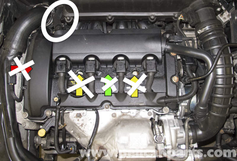

, so I opened the engine bay and I found that something leaked from the hose as shown in the picture (hose in the circle, don't mind the arrows) and it splashed all over the airbox and the areas next to it (it's little drops, not a consistent amount, and there is a little under the seal). from what I can see, it splashed starting from the seal on the engine. the hose itself is fine.

That's one of the two PCV hoses --- the one that connects directly to the intake manifold, so it sees all the vacuum and boost. If not connected properly, it will cause manifold leaks and ultimately poor / intermittent performance. It's an "unusual" connector and is designed to rotate a little bit. It can be disconnected by squeezing the outer edges to release the two latches --- sort of like a child-proof container lid. If this latching mechanism or the hose itself is damaged, you could have intermittent problems as you described.
Also note that this hose is usually quite wet with oil residue. It's common for enthusiasts to add an Oil Catch Can (OCC) to this line, to minimize residue build-up on intake valve stems.

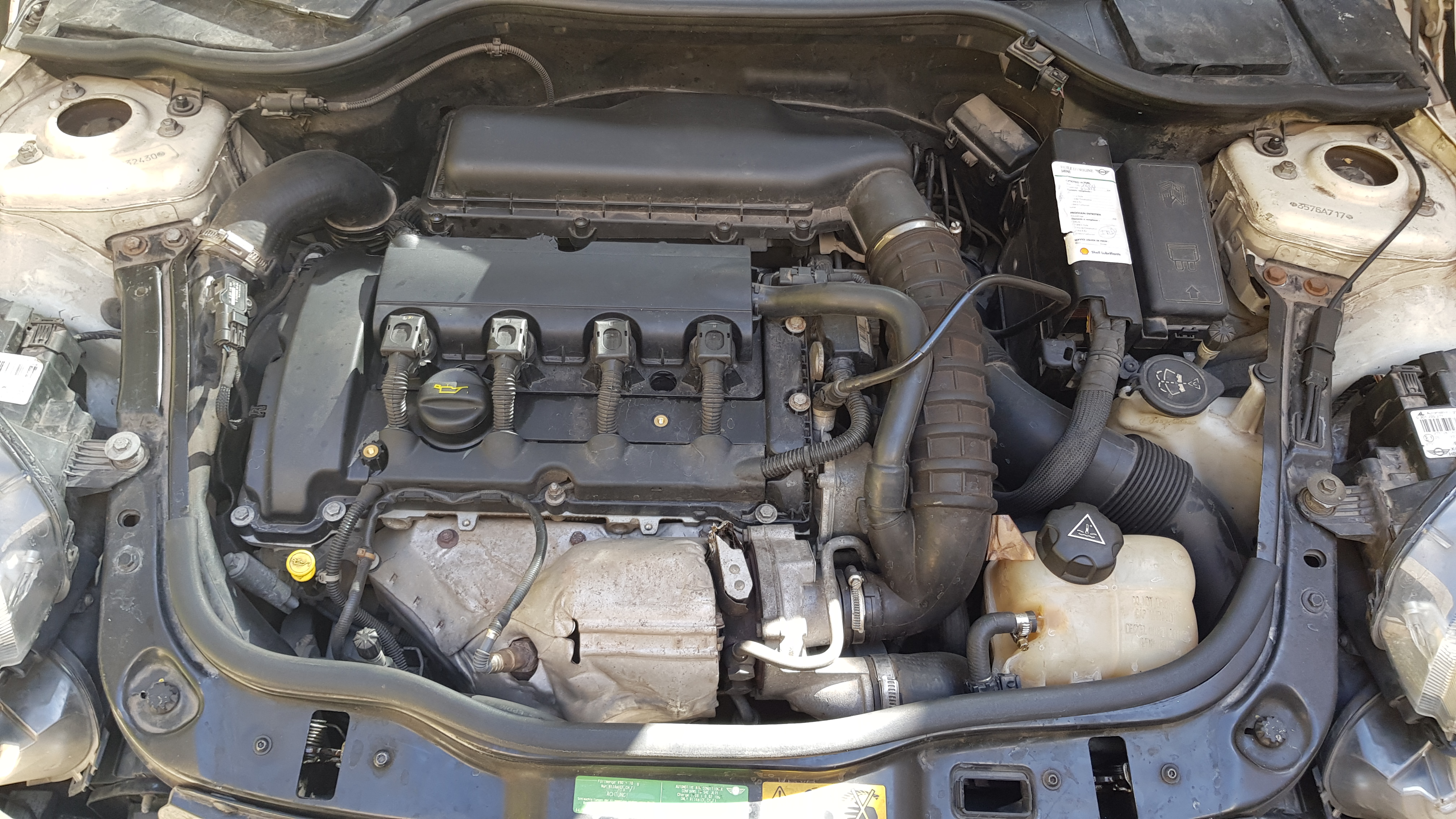

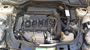

From the research that I did, It looks to me like a n14 but I attached pictures of mine so you can enlighten me. I hope it is a n18, as I have read horrible things on the n14. it is indeed a 2011 Mini Cooper s non jcw. at least that's what It says on the papers of the car. I know it is a 2011 as the exhaust has burbles which the previous versions don't have. (I might be wrong)

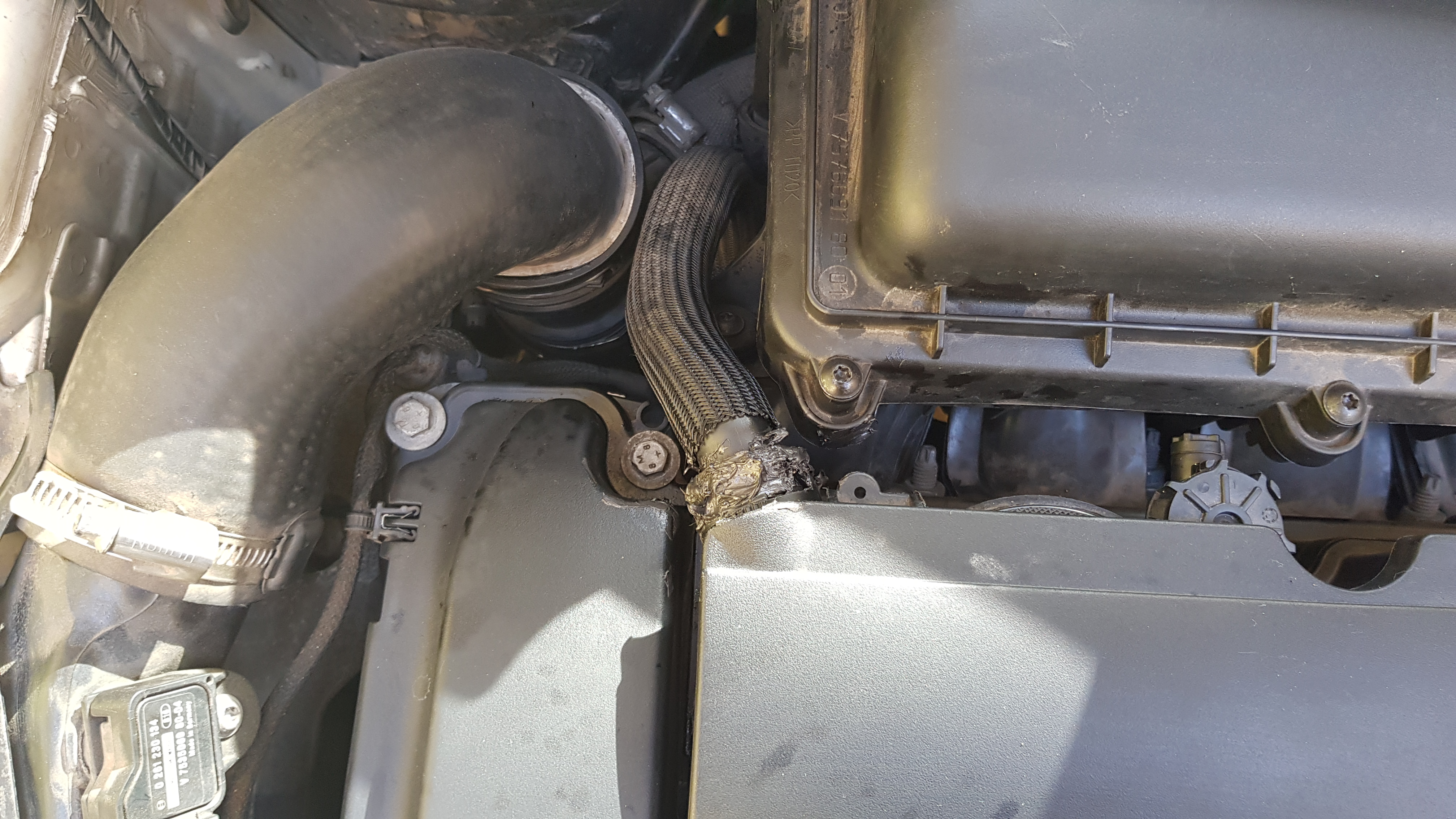

I also posted a pic of my diy fix on the pcv hose (It is very hard to find parts here in Morocco, so I did what I could)

humm, it is an N14 indeed. I dont see emission controls like we have then here in the US. at any rate, you want to know why it is leaking before you start siliconing it. is the O ring, or the spans on the plug are gone?

thats an N14!
