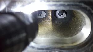

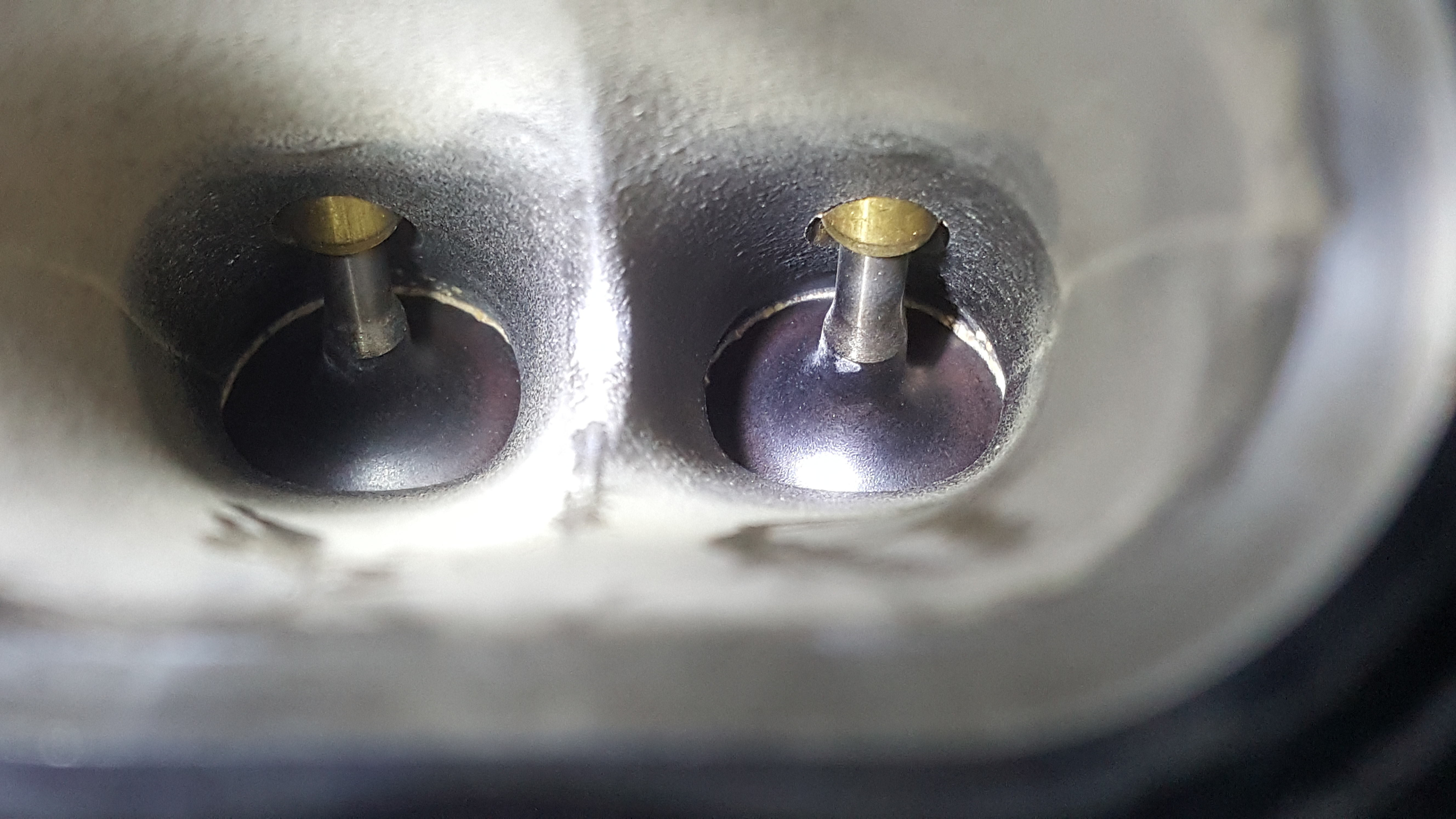

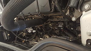

So, I picked up my Mini a few months ago with approximately 47,500 miles. Since I used to own a 335i with the N54 motor, I was very aware of carbon buildup with direct injected engines. Instead of paying for the service I decided to buy the tools and have a go at it myself. Good thing I did, I saved some dough and was able to perform the service on my Mini as well. It is pretty straight forward without too much fan fare.
After cracking open the intake I was actually surprised at the lack of carbon buildup and oil residue. With 51K miles it was actually not too bad; I expected worse. Oil residue was pretty much non-existent in the intake manifold and there was very minimal carbon on the throttle body. Good news! Since I had come this far I decided to go ahead and clean them up. The only real pain in the butt was when blasting my shop vac could not pull all the shells from the very bottom on the intake track for some reason. I didn't have this issue when I did this on the bimmer's N54. So after each blast, I would have to put another attachment on the vac to get all the way in the intake track in order to clean it up. I figure every 50K for this engine in my environment is a good interval.
End result was almost 1 mpg better fuel economy and better throttle response. Check out the pics. I was going to put them in order with comments, but either they changed something or I forgot how to do that!

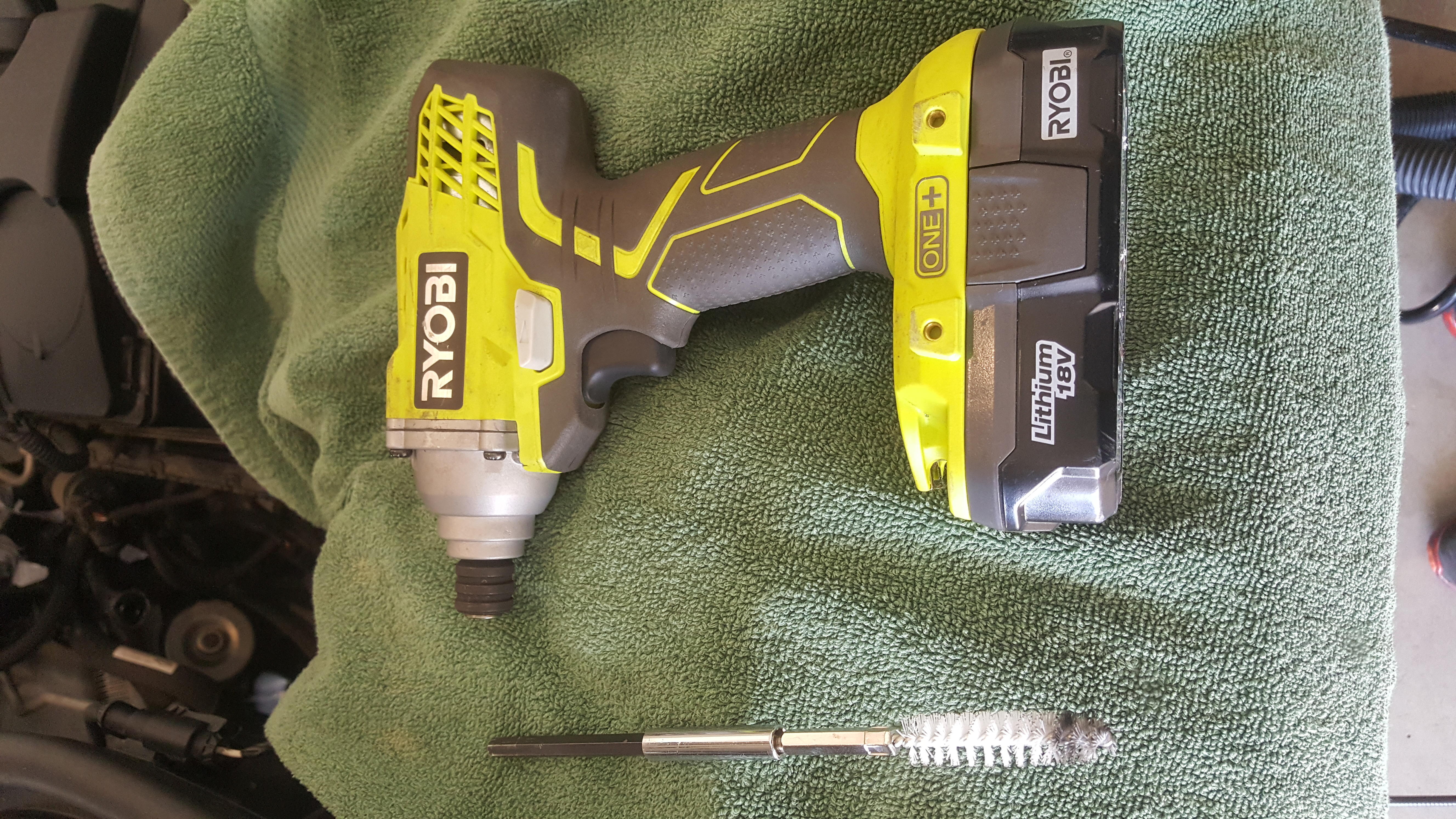

So, please post a little more about how you did the cleaning. I see the advertisement for the Ryobi drill (), but can't quite tell what the brush is. Nylon? I take it that you used those to scrub out the carbon? And how do you work it around to get to the far side of the valve where it appears to get tight?

Check out the attachments, they should give you all the info you'll need. If you decide to buy the cheaper mini intake adapter (3D printed version) vs the more expensive (metal) version. Don't be too hard on it or it might crack like mine did. I just taped it up and kept going with mine.
Also, I used the drill and attachment (nylon I believe) to remove the stubborn carbon deposits that was on the "neck" of the valves. I just worked it by feel by placing the extension in first then attaching the drill once I had it where I wanted. It seemed to work well but it did scratch up my valves a little. So maybe you can find a brush without the metal core/center if you want to prevent that from happening to yours. Also pay attention to the intake manifold removal. There is a 10mm bolt underneath the manifold that you can get to from the passenger side wheel well after you remove the tire. Your manifold WILL NOT budge until that bottom screw is out! Good luck!
