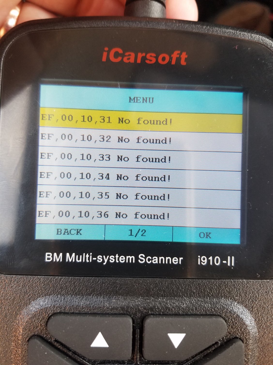

I have a 2006 R50 auto (CVT) and I am trying to clear the adaptations, but having a problem. I am using a iCarsoft i910-II tool. After I choose "clear adaptations" and it instructs me to turn the ignition on then off, I get the following screen....
EF, 00, 10, 31, No Found!
EF, 00, 10, 32, No Found!
EF, 00, 10, 33, No Found!
EF, 00, 10, 34, No Found!
EF, 00, 10, 35, No Found!
EF, 00, 10, 36, No Found!
EF, 00, 10, 37, No Found!
EF, 00, 10, 38, No Found!
EF, 00, 10, 39, No Found!
If I click on one of them it will take me through a few steps like I am clearing the adaptations. I have done this on all of them, but the car never goes into X mode (learning mode).
Any suggestions?

I have the exact same problem with my 2006, and the same screen on my C110+

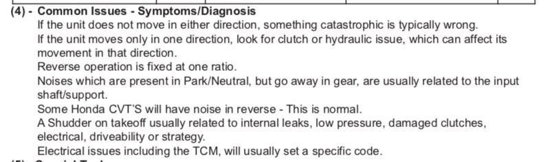

Update: This is from the AAMCO repair manual... It looks like additional evidence to support my theory on replacing the CVT control module. Because we are having problems communicating to the CVT Controller (due to the lack of trouble codes) the information above further strikes my interest in moving forward with the replacement of the Transmission Control Module / CVT Controller.

@evano I have the exact same issue using the exact same iCarSoft i910-II on my 2006 R52 Sport Mini Cooper (See photos). Thanks for posting this.
  • EF, 00, 10, 31, No Found!
  • EF, 00, 10, 32, No Found!
  • EF, 00, 10, 33, No Found!
  • EF, 00, 10, 34, No Found!
  • EF, 00, 10, 35, No Found!
  • EF, 00, 10, 36, No Found!
  • EF, 00, 10, 37, No Found!
  • EF, 00, 10, 38, No Found!
  • EF, 00, 10, 39, No Found!
In addition, I had error codes regarding the ABS sensors and DTC convertible top voltage errors:
  • 29 Switch, convertible-top locked, voltage 2.5V
  • CODE: 2321005B no description!
  • 30 Switch, hard top, voltage undefined
I haven't began to sort this out yet....
@Docsigns I've included my errors from pages 1 & 2 when attempting to reset CVT adaptations. This led me to check if there were any errrors from the DTC page, as seen in photo 3.

Errors of page 1 attempting to reset CVT adaptations
Errors of page 2 attempting to reset CVT adaptations
Errors from DTC page which led me to believe that either the rotational speed sensor was either not connecting or has gone bad.
