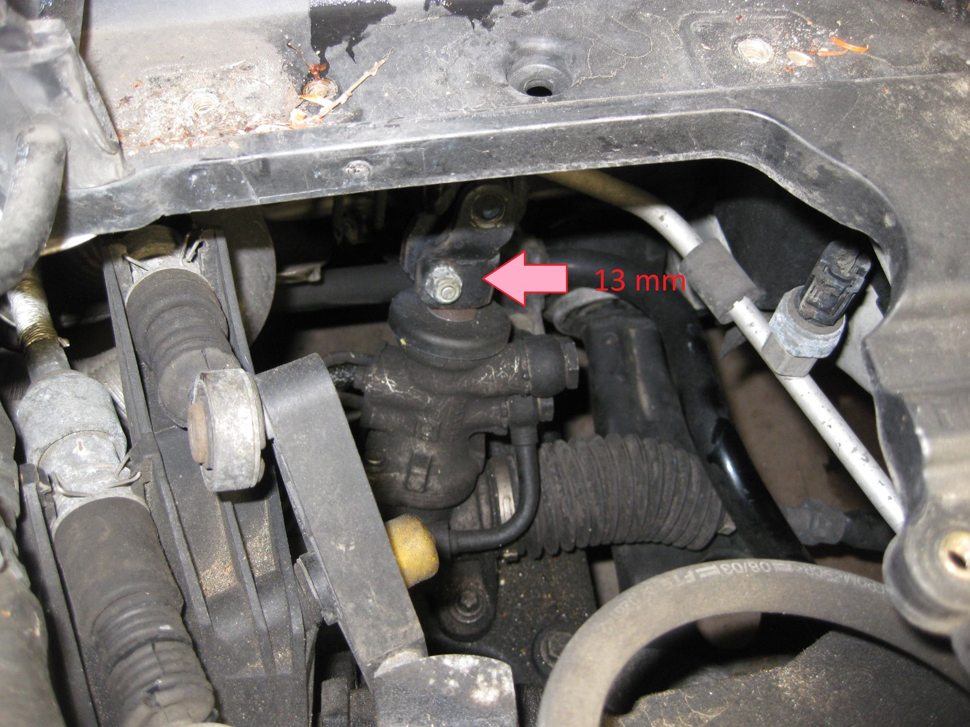

Bushings/ Ball joints? everything else:
https://www.northamericanmotoring.co...ll-joints.html
Check your Power steering lines while you are at it :
https://www.northamericanmotoring.co...hose-pics.html
and the steering column Noise: 32306870777
https://www.northamericanmotoring.co...-any-tips.html
Yes, its in that link above.
