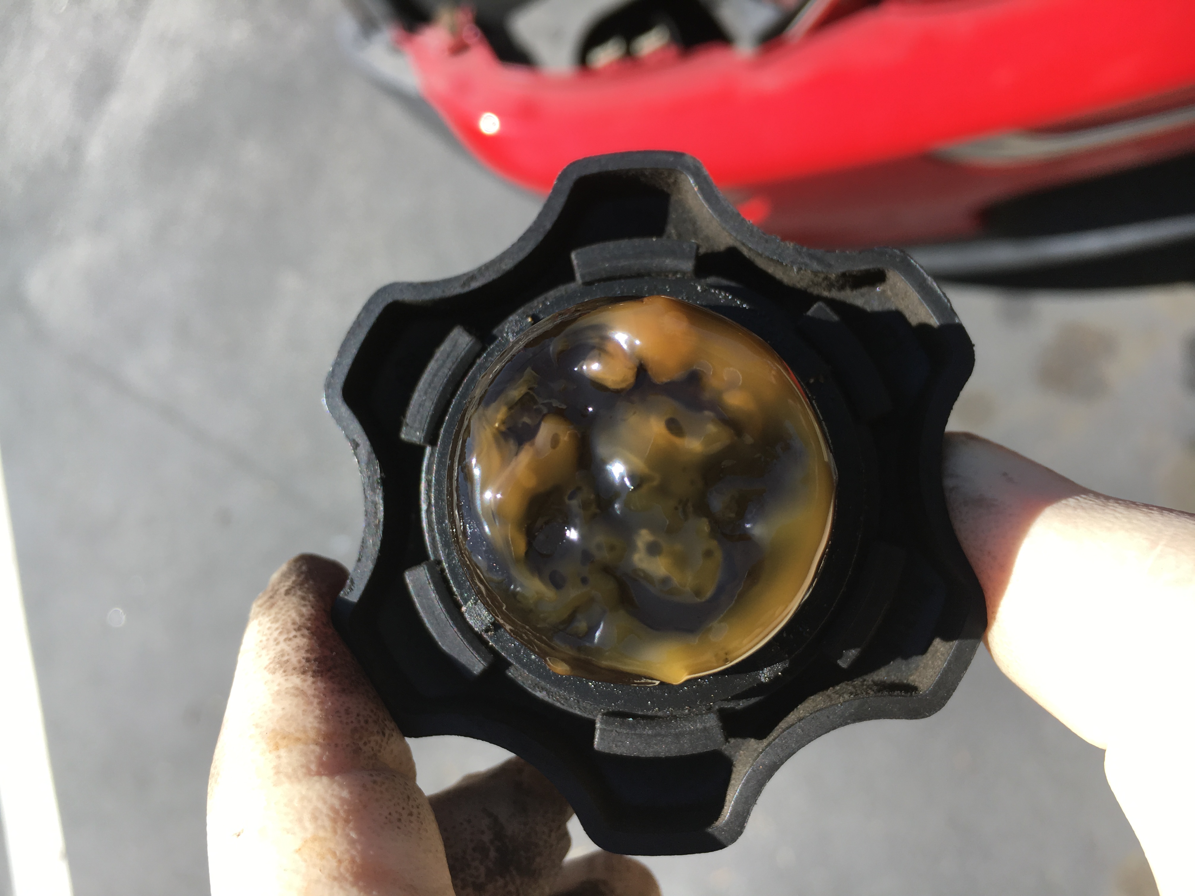

Today, after checking the oil level, I wanted to add some (have been doing it regularly) and saw a milky sludge under the oil fill cap. It's like goo in structure. Looking inside the engine through the oil fill hole, I can see that the side walls are also covered with this material. Based on experience with some of the other cars I've owned, this looks like coolant in the oil, which could be from a blown head gasket or a cracked head.

If you're lucky it could be a failed oil cooler. If not, head gasket. Bubbles would come up from the bottom of the tank, indicating combustion gasses entering the cooling system.

This. I know there's ways to diagnose the oil cooler, but I don't remember them.

I took it to a local shop about a month ago and left the car there for couple of days for testing. Compression test results were fine, and the pressure test for the coolant system didn't show any leaks (left connected over the weekend).
Since nothing indicated head gasket directly at that point, I decided to get the oil cooler replaced. I've been driving it for the last 3-4 weeks and checking coolant, as well as the oil levels along with checking oil fill cap for any "muddy" stuff. So far, the oil fill cap looks fine and there no particles or color change on the dipstick.
However, the car is still losing coolant. I'm adding distilled water once a week to get the level up to the max line. Part of me wants to solve this leak, while I also say to myself "hey, as long as it doesn't go into the engine and mix with coolant, it's fine".

Just to give closure to this thread... it turned out to be a crack in the head. After ~$2,700 (included some other items in addition to the head, head gasket, bolts, etc), back to normal (at least for the last 2 weeks; keeping an eye on everything).
