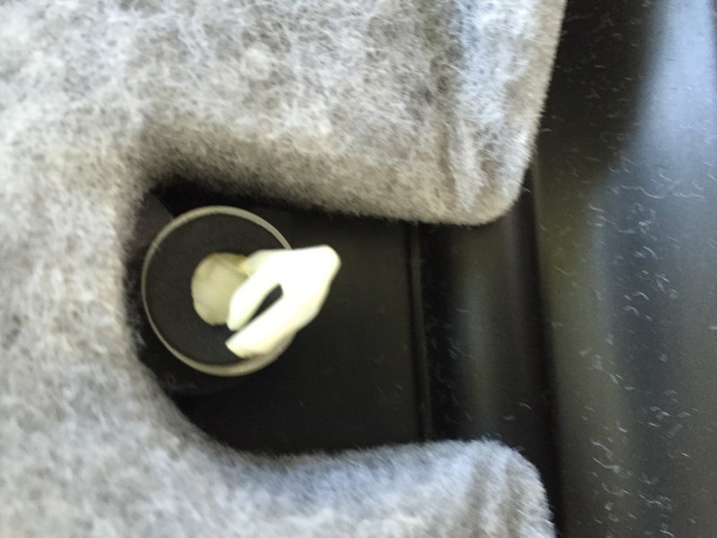

I snapped two of the white plastic clips when getting off the panel.

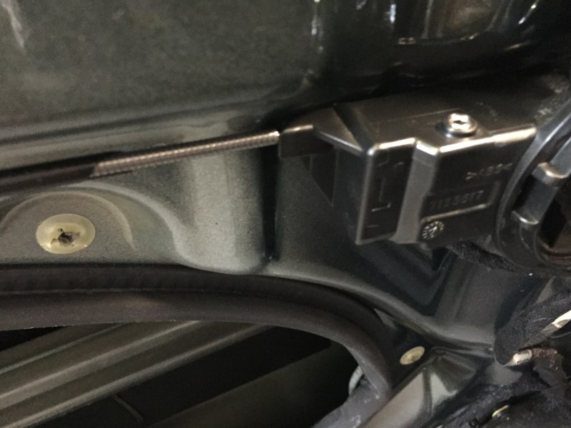

I then found the current bowden cable was missing some of it's protective wrapping.
Also found a large rubber circle gromet type piece that was laying in the bottom of the door sill.
Has anyone got any good diagrams on what the door should look like, and also how the actual bowden cable works.
Also need to find the replacement parts, found some white plastic clips from autozone, but they don't fit correctly.
Would also like to know, what keeps the operating pin rod, in the upright position? The actual interior trim l'm guessing?
Attached pics, parts wise l need a new hex screw for the right hand lower side of the trim, two of the white plastic clips, bowden cable possibly, and a new rubber circle gromet. Although not entirely sure where this is missing from.
How should l replace the bowden cable?

The "Bowden" cable is usually stretched, but sometimes the mechanism is bad...so eBay 3rd part units are junk and flex too much...
Look it over...I'd try the cable first the rest looks ok...
And a warning...since you need to OPEN THR DOOR to get the panel off the interior of the door off, be careful....
My suggestion...look at your other door...it's the mirror image.

Here are those clips: 51418224768 they include the foam gasket to help rattle noises.

The foam gaskets , we dont have them come on each clip.

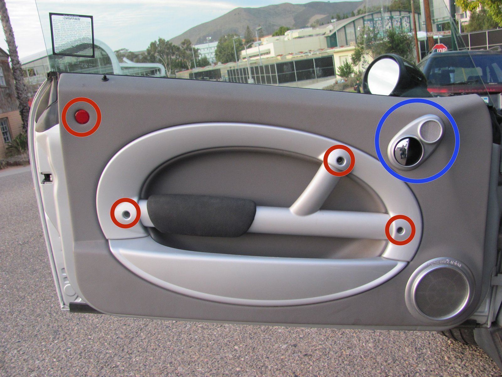

The hex screws which go into the slots highlighted in red on this pic.
https://d3nevzfk7ii3be.cloudfront.ne...FeaBr5Wwx.huge
Believe it's a T30 torx screw, if you have the set that would work to....Of the four screws, two are 18mm and the other two are 52.5mm long
