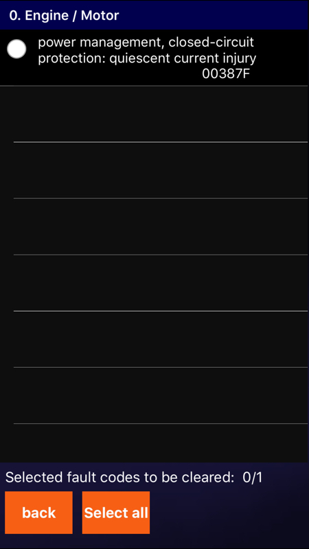

Got this fault code: 00387F Engine/motor: power management, closed-circuit protection: quiescent current injury. Any idea what is this?
