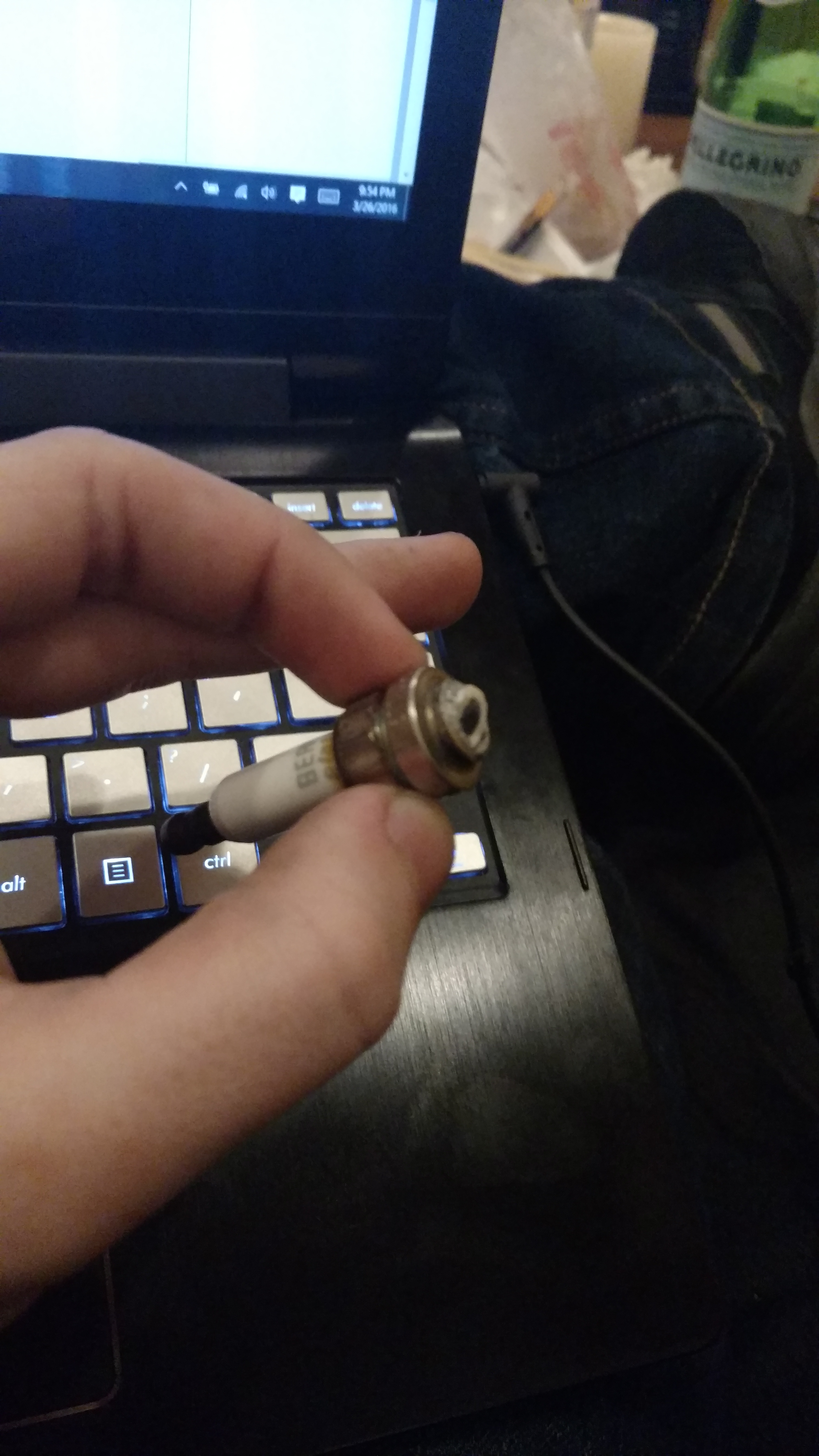

This is the half I have
It snapped clean off
Attached Thumbnails Spark plug broke, now I'm panicking!!!-img_20160326_215424705.jpg

Looking at that pic, I'd say your first job is to attempt extracting the remains of the centre electrode.
