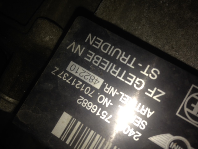

Had a transmission line crack this week. Need to replace the transmission fluid. There was a recall in 2013 (?) on the CVT transmissions. Bought the mini used, so we're not sure whether the transmission was replaced in the recal or not. Can someone please tell us from the photo of the label if this is an original transmission (CVT) or a replacment? Tried google for over 2 hours and couldn't find ANYTHING! The first 4 digits where the glare is, are 2400.

ZF, that's what it says!
Could be http://www.mini2.com/cvt/zf_vt1f_gea...escription.pdf

Guessing it is a Cooper,..(gen 1).if it is, it is a CVT....
And the CVT was made by ZF...PRETTY SURE...just getting my guess since not sure which data plate you found...
Iit is a Cooper s (gen1) it has the ASSIN....
There was a recall...and a settled class action lawsuit...so find a knowledge person at the dealer to lead you through the process....but think you are a day late and a dollar short....

Yep thats a CVT.
GACVT16Z - UZ
Older CVT part number thats NLA. 24007516682
https://www.ecstuning.com/Search/SiteSearch/24007516682/
Newest part number 24007573542
https://www.ecstuning.com/Search/SiteSearch/24007573542KT/
CVT info: https://www.northamericanmotoring.co...ettlement.html
