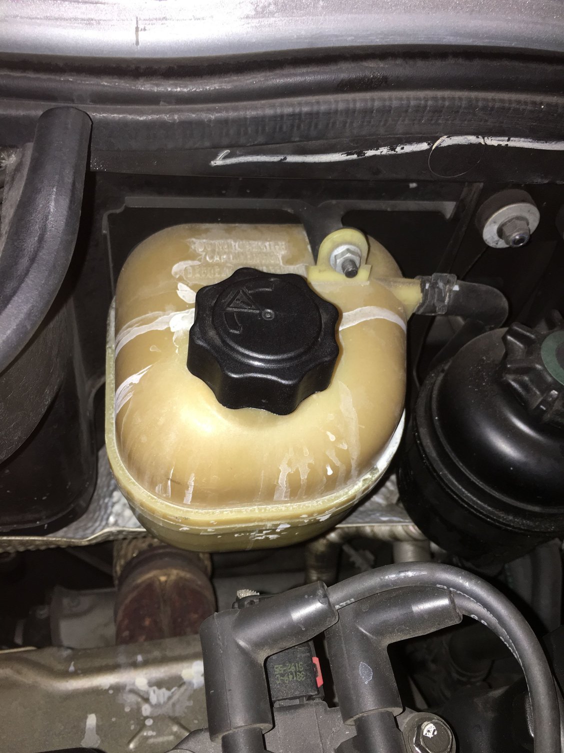

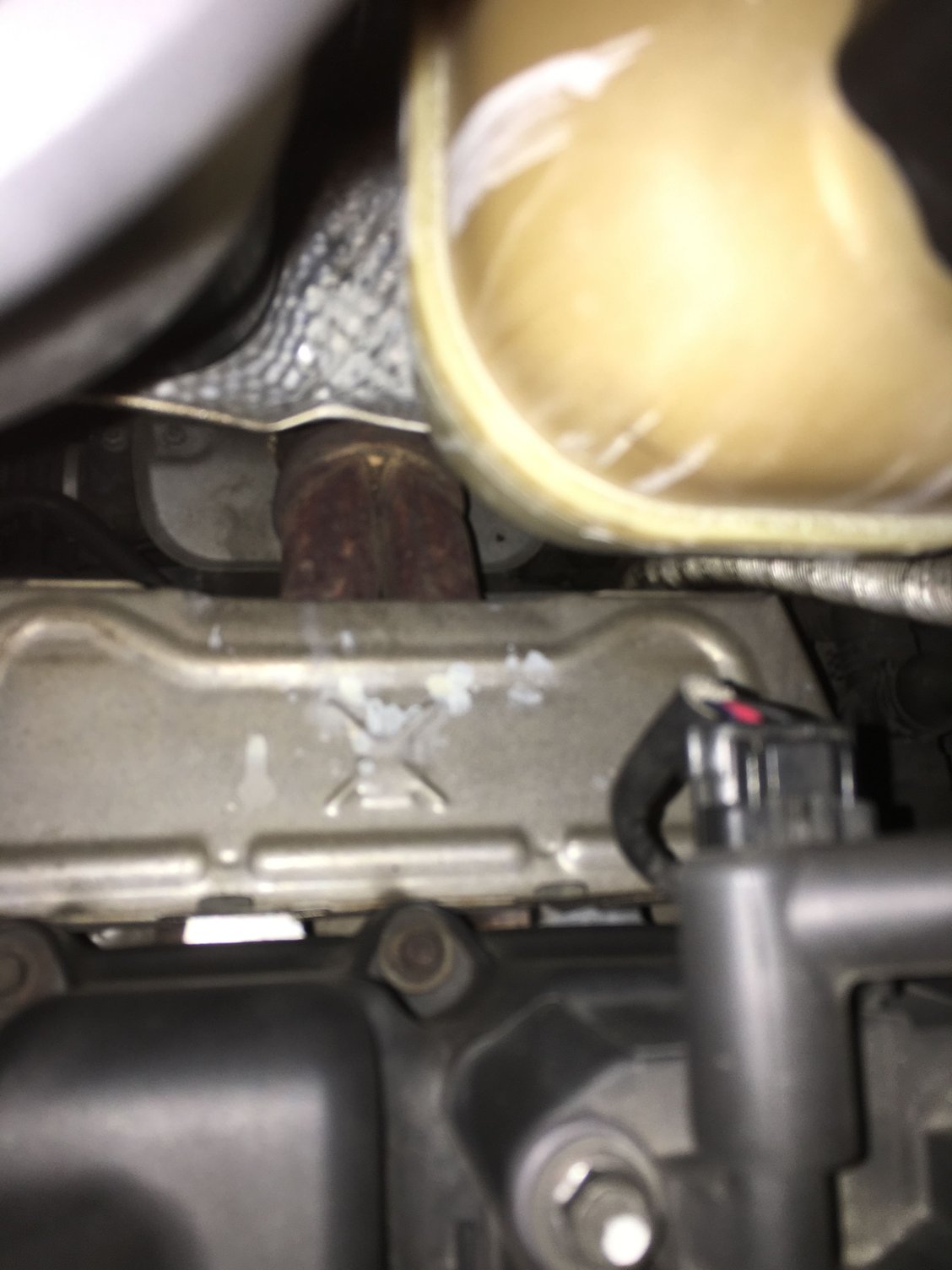

Here's a picture of the tank and what's under it. It looks clear to me that's it's overflowing from the cap? Should I replace the whole thing or just the cap? Also should I get another oem or a nicer aftermarket aluminum one?

Originally Posted by X757XVeritas
Not on a Mini, that cap should be sealed tight. The reservoir is pressurized as part of the system unlIke traditional overflow tanks
It's literally a reservoir. It's extra coolant underpressure. Nike a regular tank that catches the extra being pushed out.
OK. I didn't know that the S is different. The non-S just has a flip snap-on cap and it isn't pressurized.

Oh, I didn't know the non s wasnt the same! And to the OP, that depends on what you wanna spend. I'd replace the whole reservoir at the very least. But whether you want to fork out the money for aluminum is up to you.

Originally Posted by SmurfNinja
Yeah the coolant is low. Just put some more in. It looks like I need a new resovior tank. I think it's leaking through the cap of the of the tank and dripping ontop the metal below it causes steam to make the engine bay overheat
The seal on the cap may be bad. Check it over and also check the seams around the coolant tank to make sure the tank isn't leaking as well (view image below). Replace whatever is leaking and make sure to fill the system with 50/50 MINI blue coolant.
Cap - http://www.pelicanparts.com/catalog/..._pg1.htm#item4
If the expansion tank is bad, it comes with a new cap (the aluminum one doesn't) - http://www.pelicanparts.com/catalog/..._pg3.htm#item9
Coolant - http://www.pelicanparts.com/catalog/..._pg1.htm#item0
