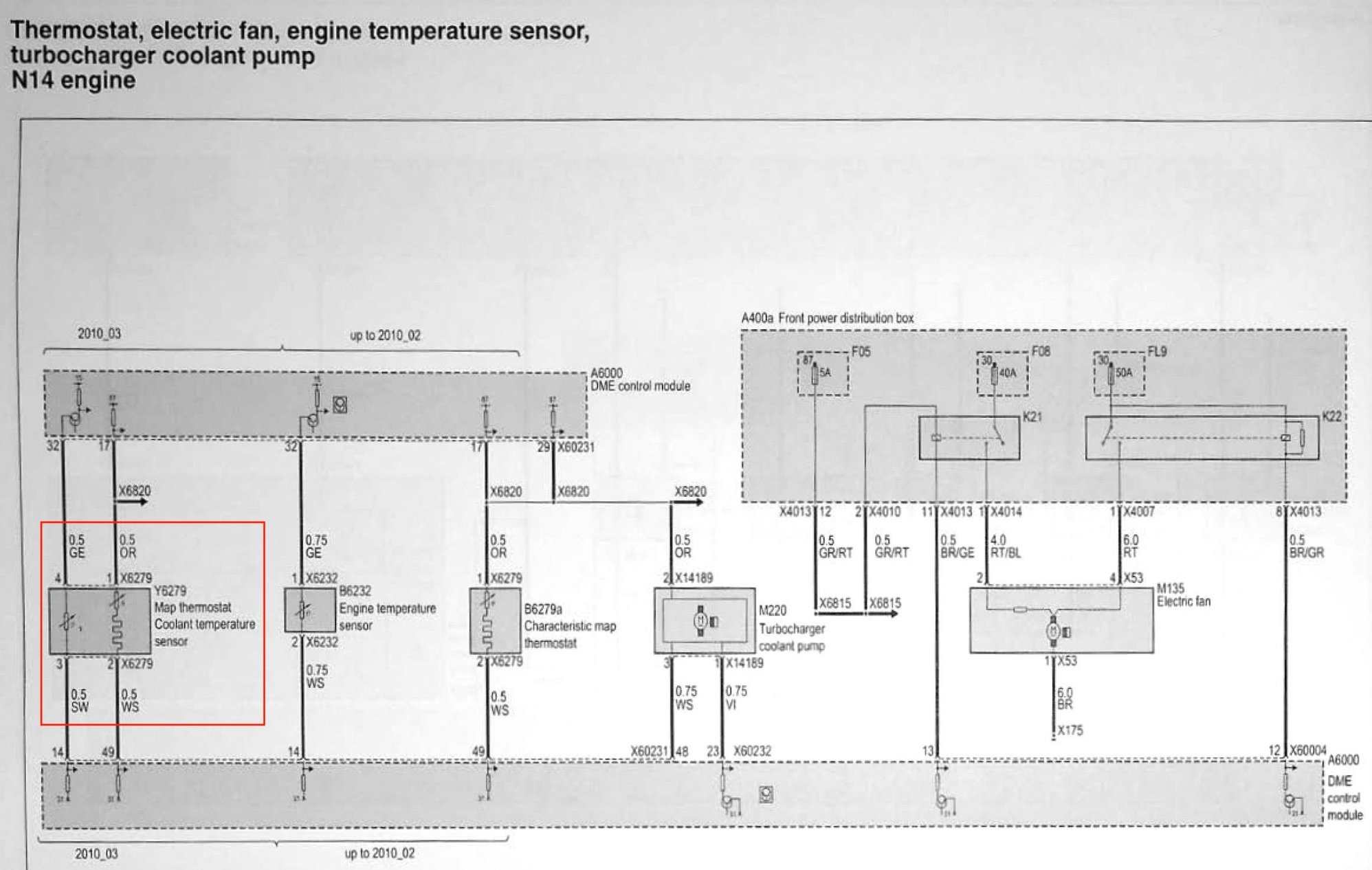

What BMW fault codes are stored in the DME?
The service manual shows that the coolant temperature sensor and map thermostat share a 4 wire connector (coolant temp sensor, yellow and black wires; map thermostat, orange & white wires).
Does the coolant temperature still read 286F with the coolant temperature sensor unplugged? When unplugged, is a different fault code found?

What are the wire colors in your coolant temp sensor connector? Do either of the two wires have voltage reading?
Do you have a scan tool that reads BMW fault codes?

I believe the DME normally supplies 5 volts to the coolant temperature sensor to calculate the engine temperature.
In contrast, the engine breather heater relay supplies 12 volts to the engine breather heater.
By swapping the two connectors, the engine breather heater relay supplied 12 volts to the engine temperature sensor. This high voltage could potentially damage the engine temperature sensor, its two wires, and/or the DME. This is what you should consider moving forward. I hope its either a damaged wire or sensor. Good luck!
