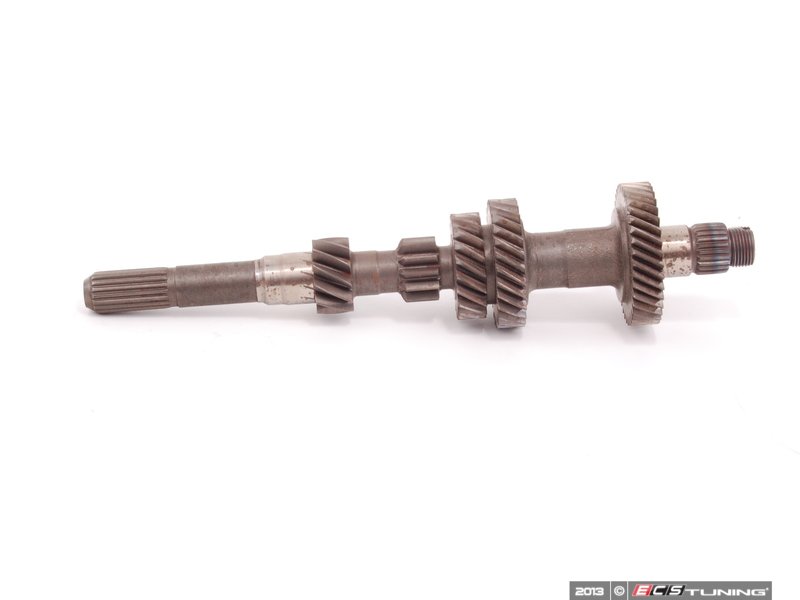

You can rebuild the Midlands 5 speed (2002-7/2004) and you can get the parts.
Check those shifter cables first on top of the transmission and the shiftier lug, make sure the move freely and are not stuck or seized.
http://www.realoem.com/bmw/enUS/show...diagId=25_0386
#1 and then look at #7 and #6 cables.
Then go to the transmission internals, open up the transmission and see what is broken.
Here is a DIY,
https://www.northamericanmotoring.co...mentation.html
If you cant do it yourself , I would get a transmission shop in your area to look at it that knows MINIs or BMWs.
Its one of the few MINI transmission you can get internal parts for.
http://www.ecstuning.com/Mini-2002-Cooper-R50-Base-Coupe-L4_1.6L_W10B16A/Drivetrain/Manual_Transmission/
Good luck and hope that helps.
