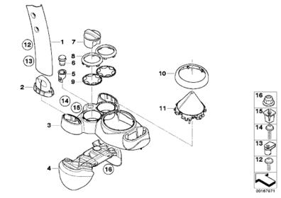

So, I've found a lot of threads with people complaining about their dash down tubes rattling but I haven't found any solutions. My passenger side tube especially rattles like crazy, and I've already removed the silly OEM cup holder. Also, I noticed that when I removed the two T25 torx to remove the cup holder, the whole down tube fell about 3 inches down into the center console. Is there maybe supposed to be something supporting it from underneath or within that would prevent the rattling that has gone missing?

ah... Yes... there should be some compressed foam inserts at the base of the Down Tubes...
See part #2 of the image
I was looking for the part number... But I need to know what year and model car you have.

In my case the noise was coming from between the pieces 3 and 13 on the picture above. I just folded a small piece of paper, unscrewed the screws on the grey pillar and pushed the pillar up. Then I put the pieces of paper on the bottom of the pillar and pushed it back down so the paper is not visible. That solved the problem.

mine creaked there and at the top of 13 where it met the dash. thats where i put the tape.
