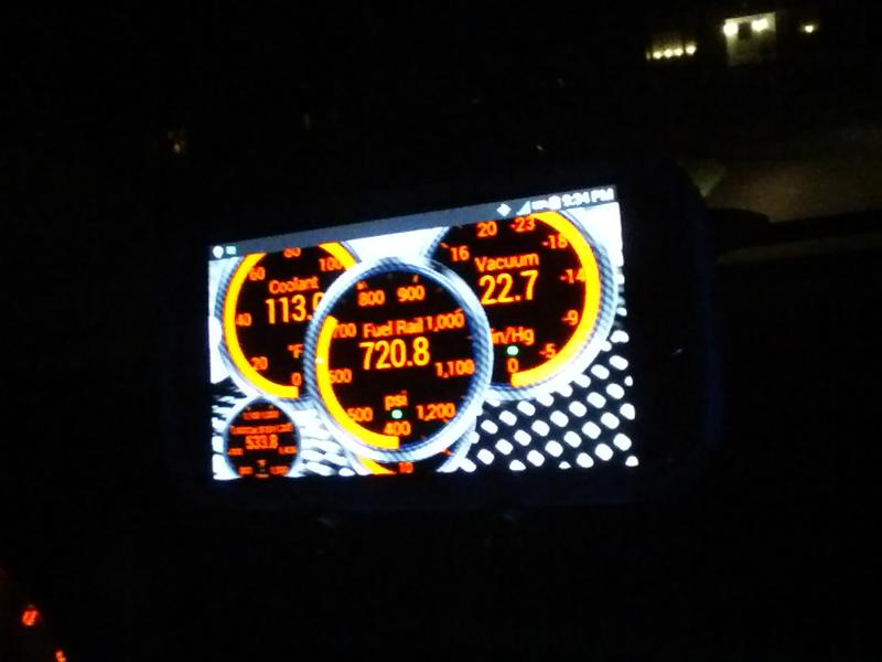

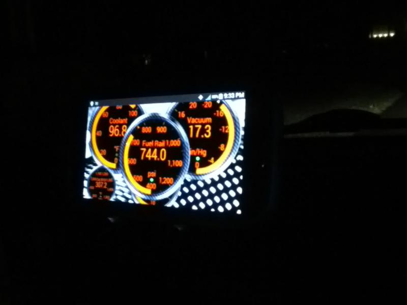

Hi Howie,
I'm using the Torque app on my Samsung III phone. I am able add a gauge using the app. by accessing the Fuel Rail.
I have attached two pictures of the app with the Fuel Rail gauge enlarged. The photo was taken with the engine at idle, app. 800 RPM.
Honestly, I'm not a tech, so I can't tell you if this is an accurate way to measure the output of the High Pressure Fuel Pump, but it does give a baseline to compare.
If I can help further, let me know.

Thanks guys! Now if only I had an Android phone... :( I'm pretty disappointed that my Bavarian Technic wont read fuel rail pressure, seems a little ridiculous. I have a friend that I think has Torque, I will see if I can get his help!

I'd pick up a cheap junky android tablet just to run Torque. It's too useful not to have. As for the fuel pump, even if it's not currently the problem, it will be eventually, so there's no harm in buying one now. :P
As already stated, the fuel rail pressure at idle is about 700PSI. It can reach about 2,200 PSI under high load. When my HPFP failed, fuel pressure held constant at about 60PSI. This also seems to be the pressure that the fuel system reverts to if the car goes into limp mode for reasons unrelated to the fuel pump.
Interesting info about the 60PSI, good referencing point. And to the OP there are quite a few Windows apps that also run bluetooth diagnostics. Failing that google bluestacks which runs a virtual android system on windows also works.
