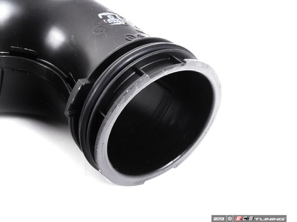

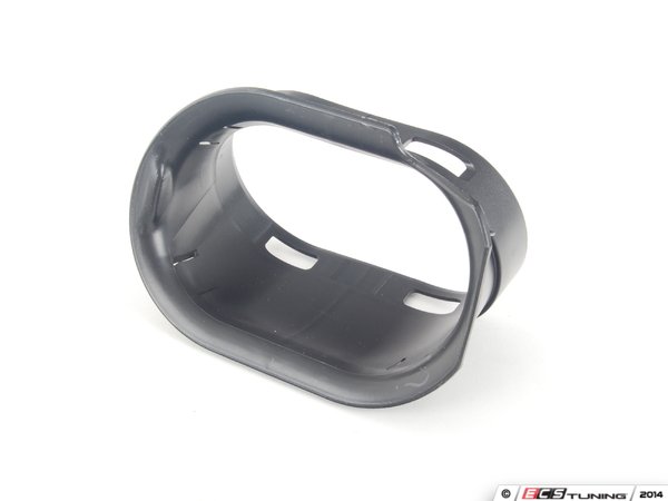

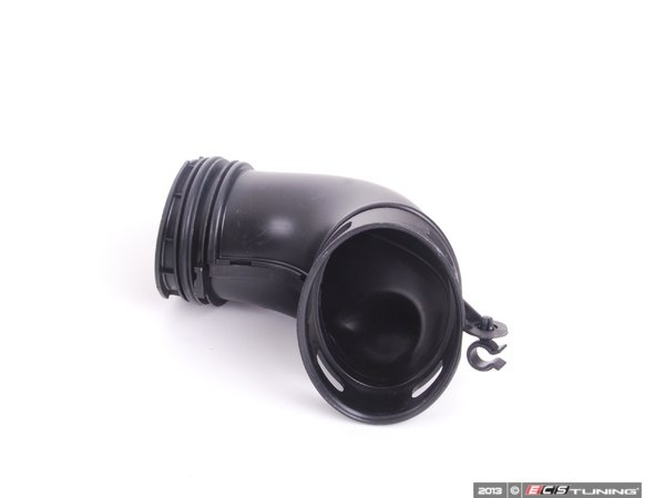

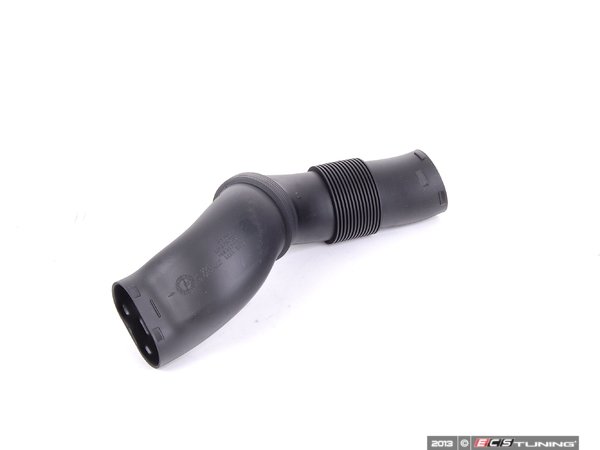

Believe you are talking about # 8 , this snaps into #9 which can sometimes snap the tabs. That unit snaps into the side of the core support near the headlight . Other end of #8 snaps into the bottom , then twist and lock into the bottom ogf the airbox. If you have the factory airbox or JCW kit closed airbox these have to be connected to funnel the air. In aftermarket it would still funnel cool air back there, especially when driving down the road.
# 8 Intake tube Part # 13712753070
http://www.ecstuning.com/Search/SiteSearch/13712753070/
#9 Intake scoop 13712753073
http://www.ecstuning.com/Search/SiteSearch/13712753073/
#7 Intake Manifold Tube - Short Elbow part # 13712753082
http://www.ecstuning.com/Search/SiteSearch/13712753082/

+1 , its not that hard, the pieces and connection diagram is listed above. The trick to #6 ( which is the hardware ) for #1 to #7 is to lift the airbox out a bit and tilt it above 90 degrees line up the end of #7 insert it into the bottom slot and turn the box forward and twist and lock that piece.
#7 elbow tube.
For #7 to #8 , #8 to pinch the tube with your hand inwards on the sides, then insert the tabs into the tube to #7.
