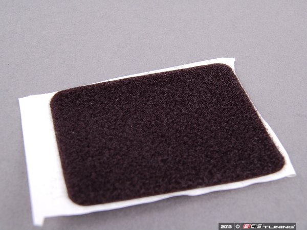

I have found that 3M style sticky back ( peal and stick ) felt work in some locations. Soft side of velcro stripes. You can get it in thick pile and softer pile. Works great on the plastic on plastic connections, also most of the time it matches and not seen because its dark black. Cut to fit in locations.

Thanks , so its not a plastic on plastic. Looks like might be because the top is down and just setting there. When the R52 MINI Convertible first came out they had some interior cracks and noise. Which was fixed mostly by felt spacers and Velcro backing by dealerships . That's also the main pivot point with the top folded on itself , it its might be a seal on the pivot. Do you have an actual picture. I also check to see nay TSB' s and I don't see any yet for the R59 top for that.

On the dash/ column parts try the felt / Velcro trick. Were you able to get a video of picture of the squeak area ?

My Roadster has velcro padding all over the dash from the factory (or maybe it was from the dealer). lol
