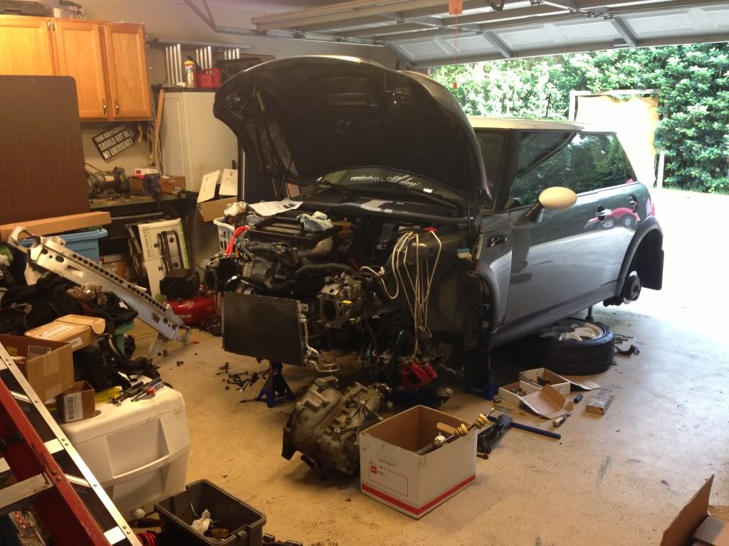

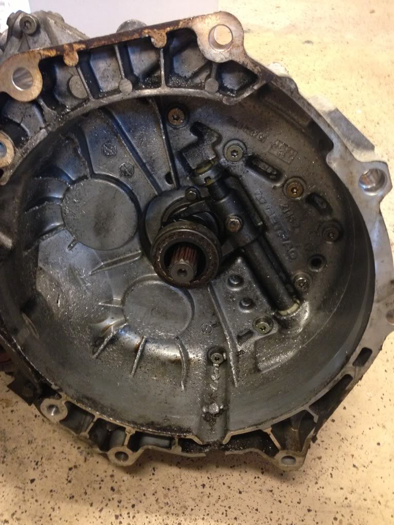

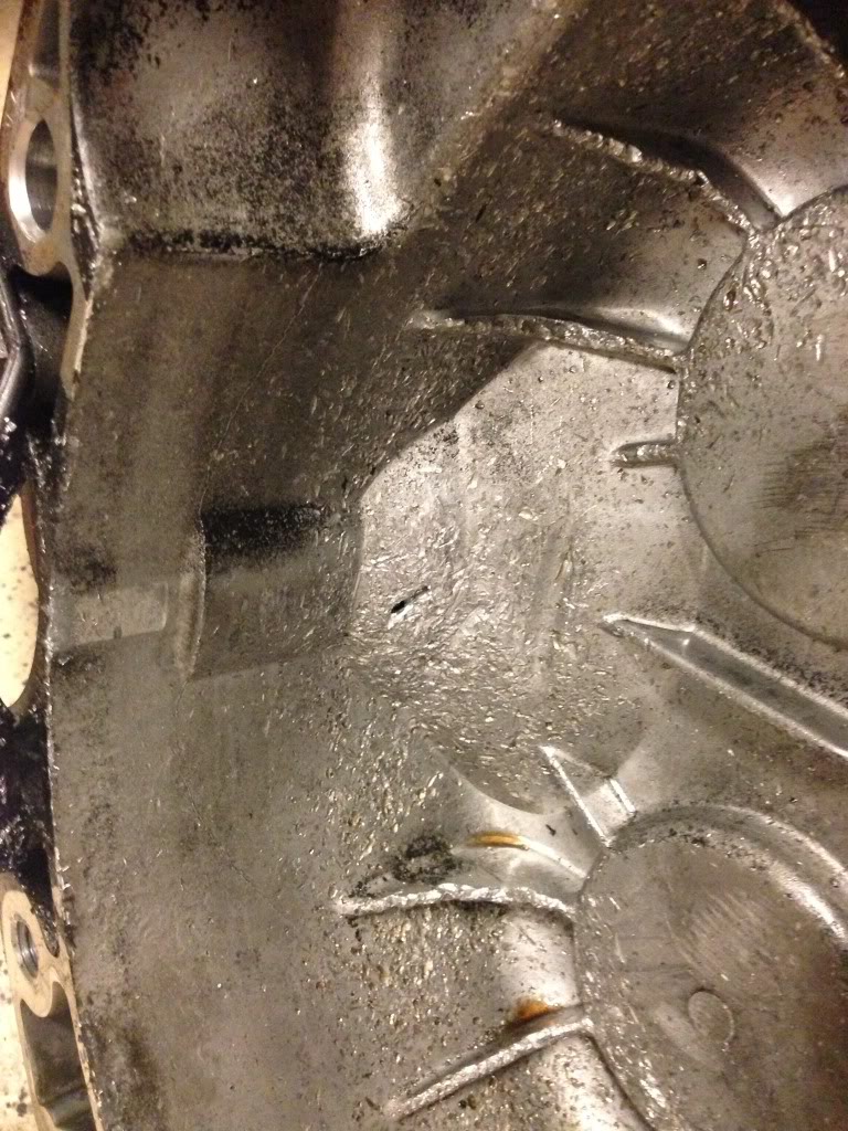

Well, finally got around to getting the trans completely out. It was worse than I thought and sets me back so much. What I'm assuming happened is the throwout bearing failed, causing shrapnel, which gashed into the trans case, caused the leak which made the clutch slip. Pics of the massacre

The gashName:  null_zps1663dfed.jpg

Ouch!
If you know someone that can weld aluminum they should be able to plug it for you or use the good ole jb weld patch on it.

I'm towards Daytona, in DeLand. So our trans are aluminum? Or are they cast?
I'm probably going to end up jb welding it. I just want to make sure it holds.

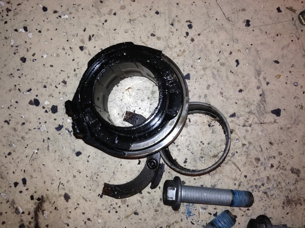

Can you post a picture of what was left of your throw-out bearing?

My throw out was come rely disintegrated if I can figure out how to post photos from my iPhone I will.

Here's the throw out bearing. I trust the JB. I've used it before at different times, I got the industrial type, high psi & temp. Shouldn't faze it. As there won't be anything grinding or rubbing on it

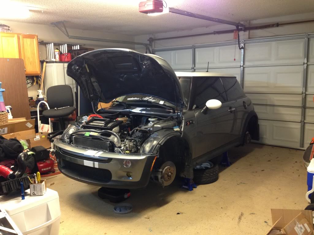

And put on my coilovers while the car was down.

It looks to me as if just the plastic/nylon portions of the throw-out bearing disintegrated, and I have a hard time agreeing that it would be sufficient to puncture the bell housing portion of the transmission.

The piece in the middle of the bearing and bottom washer is half gone. Which in fact is metal. There was metal shards that have been rounded and were in the bell housing. They did not come from the transmission and I couldn't find anything wrong with the clutch, pressure plate or flywheel. Other than the fact they all have been peppered from the metal.
