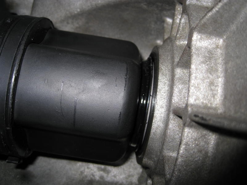

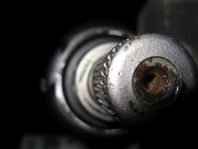

I have taken off the Lock Ring to try and fit in the drive shaft to see what it looks like. I have taken two pictures and does this look right? I have a feeling it not correct because the drive shaft needs to go further more in?
Please let me know.
Thanks.

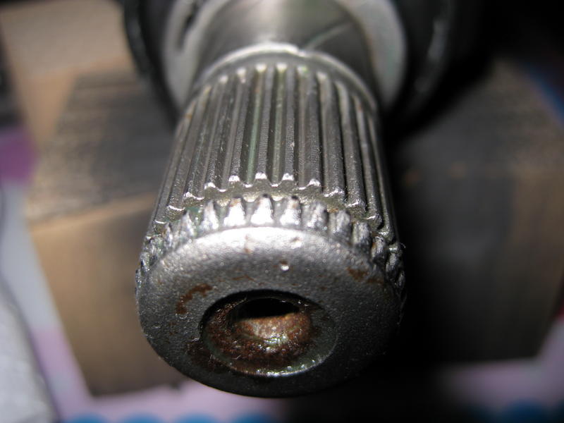

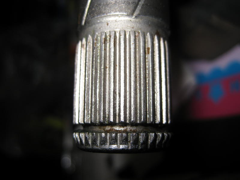

Hello,
I attempted to install the driver (left) shaft (Part #31607574852) into the differential, but I was unable to go past the beginning of the Lock Ring.
I suspected that the Lock Ring was the problem at the end of the shaft. To prove this to myself, I carefully removed the Lock Ring from the shaft and I attempted to reinstall the shaft again. The shaft would not go onto the splines in the differential.
On close examination of the shaft splines. I can see that the splines at the very end near the Lock Ring groove do not line up with the main splines on the shaft!
Mini of South Atlanta sent me a new shaft and I sent the damaged drive shaft back.
It worked out okay with the new shaft in the differential and the dust cover was fully close up to the transmission outside surface where it should be.
Here are the first three photo shows the damaged splines at the end.

Here is another first photo of the damaged splines and the 2nd photo new drive shaft installed into the differential.

Ouch. Was that an OEM axle assembly with the offset splines? Glad it worked out for you.

Yes, it was a used rebuilt axle and I assuming whoever rebuilt it didnt check the splines carefully at the end of it. I was struggling for awhile trying to get it in the differential. I am glad it done now.
