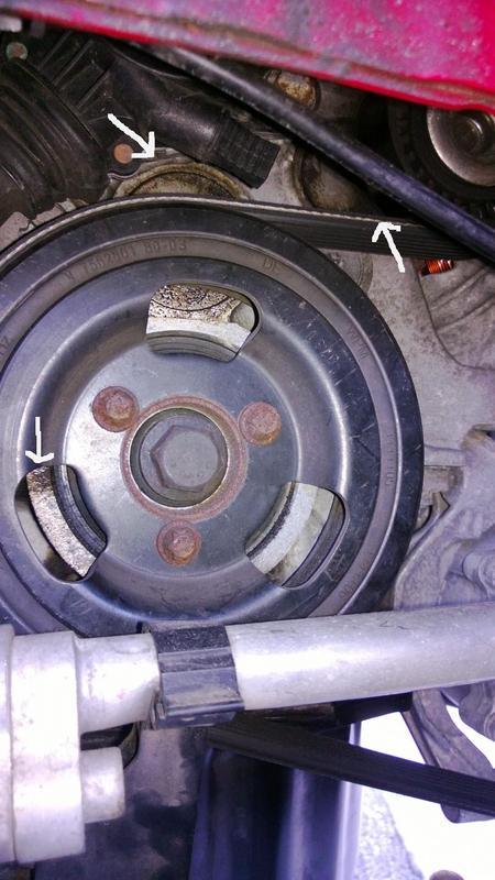

possible location of leak
Originally Posted by sripavan
Dear experts,
as seen in the attachment, I see oil all around the pan. I also checked on the wheel side by pulling the wheel arch cover and there is oil there as well. I am not a 100% sure if this is just oil pan gasket or something dripping from near the pulley's and spreading all around the pans lip. Any suggestion before I conclude its the pan and go ahead and change it. I would like to get some input as to where else it can be leaking so I can go take a look at those places as well.
Thank you in advance.
Pavan
Thank you all for your response. Now, I removed the splash wall behind the tire and looked closely to see if the oil is dripping from above. As from the picture attached, I seems to be coming from above the pulley. At least looks oily even there. Not sure what is up there to cause the leak. Not sure if the pulley is smearing oil as it rotates? Any insight is helpful. I have also cleaned the oil pan with a break cleaner. Will see if it shows something tomorrow. Thank you in advance.
Attached Thumbnails Minor oil leak at crankcase gasket. What's the cause?-oil-leak1.jpg
Old Mar 21, 2013 | 06:48 PM
  #28
boOst spIKe's Avatar
boOst spIKe
Joined: May 2012
Posts: 154
Based on your above picture, it doesn't appear to be your front crank seal to be leaking fluids (might be mildly sweating past the seal, but nothing that is causing what you are seeing). I have seen plenty of oil pan gasket leaks that will sweat and leak upward towards the harmonic balancer/crank pulley and beyond (pending on severity of leak). I've seen oil pan gasket leaks so bad that fluid had worked itself far up the frontside of the engine block appearing as if the oil filter housing gaskets had failed or even potentially the turbo oil return and supply lines were leaking when it was nothing more then the pan gasket. People often think fluid dynamics (even when it comes to leaks) always follow the principal of gravity, and while they do in many situations, they do not always especially in leak situations.
Either way, if you want to be 100% sure you could just replace your pan gasket as well as front crank seal. Neither of the two are very difficult in terms of install (other then you will want to lock your crank/flywheel to ensure your vehicle does not jump timing when removing crank hub) and service/part(s) cost are minimal for both repairs. Please, do not be one of those numskulls (if you choose to do your front crank seal service) who decide "oh I can reuse my crank hub bolt" and do so. The crank hub bolt is a TTY bolt and should only be used once. Also, if you do plan to do the seal repair, please properly torque the crank hub bolt (per MINI procedures). You'd laugh and maybe think the good ol' German Torque Spec of "Gut Und Tight" will more then suffice, and It will until your hub walks a few thousand miles down the road. I've seen this happen more then I'd like to admit by people and even shops that reuse or just plain disregard proper install procedures.
Just food for thought.
Good Luck!

Hats off to Way and Crew at Way Motor Works !. My leak was the tirbo oil lines not the oil pan ! I bought one of there turbo oil line kits today.
I was at his place at 11am. He had a few other suggestions. He knows Mini's well ! Back to my place by Noon and drove home at 6. NO more leaks. I didn't have to remove the turbo. Great kit Way ! Your the Man !

I thought it was my pan. Cleaned it with brake cleaner and watched...It came down the front of the block. Way over at Way Motor Works said it was the turbo oil line... Well he was right
I bought the turbo line kit from him . Took about 5 hours. Now I'm oil leak free !
