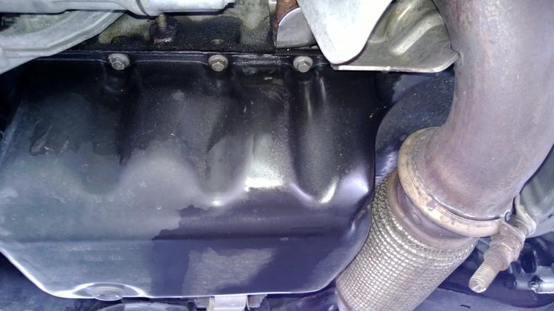

not sure where my leak is coming from
Dear experts,
as seen in the attachment, I see oil all around the pan. I also checked on the wheel side by pulling the wheel arch cover and there is oil there as well. I am not a 100% sure if this is just oil pan gasket or something dripping from near the pulley's and spreading all around the pans lip. Any suggestion before I conclude its the pan and go ahead and change it. I would like to get some input as to where else it can be leaking so I can go take a look at those places as well.
Thank you in advance.
Pavan
Attached Thumbnails Minor oil leak at crankcase gasket. What's the cause?-wp_20130316_002.jpg
Old Mar 18, 2013 | 06:36 PM
Braminator's Avatar
Braminator
Posts: 7,242
Likes: 55
From: Wherever she takes me.
IMO the oil pan in the picture definately seems to be weeping.

Originally Posted by sripavan
Dear experts,
Pavan
As mentioned above... check your front oil seal. Mine looked much like your picture before it was fixed. Oil was seeping out around the pulley area. Changing the oil seal fixed my leak, didn't have to touch the pan or gasket etc. (except for pressure washing to remove the crud).
