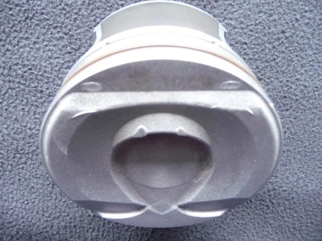

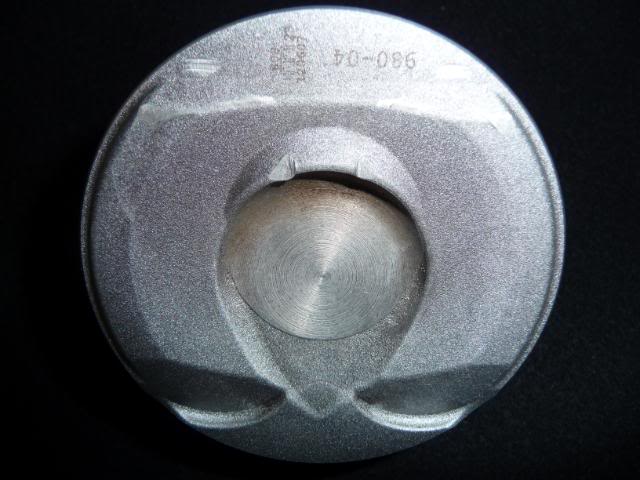

You'll be looking a long time for any timing marks relative to correct timing, there are none!
And if as you say you've suffered from timing misalignment, then you most certainly will have had the gentle kissing of piston/valve contact, and will look something like this.
The engines timing is set at 90º BTDC there is a location hole in the back of the flywheel (manual) flex plate (auto) and this is located through the engines Aluminum crankshaft cradle bed plate, to the right of the exhaust pipe when viewed from the front of the vehicle, this will then put the crankshaft at 90º BTDC and the camshafts will then need to be checked and aligned using their specific locating tool, and they can be misaligned by 180º so be very very careful to get them the right way up, you will be able to tell they are the right way up, as between cylinder lobes 2 and 3 on each camshaft, you will see manufacturers identifying print marking, quite clearly.
