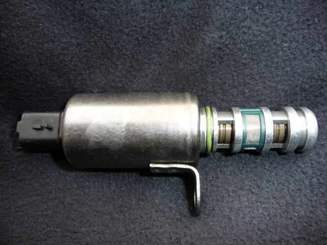

Originally Posted by Bigprfed22
Yeah the camshaft position sensor is right by the tensioner, could have pulled on the cables by accident, Check them to be fully inserted into the harness as it is notoriously flimsy.
Done this myself as well when i installed the hotside pipe.
If your referring to the sensor right next to the timing chain tensioner, as in the image below:
This is not the camshaft position sensor, it is actually the electro/hydraulic vanos control solenoid, sorry for being pedantic, the camshaft position sensor is located on the camshaft cover.
And here is the camshaft position sensor, in situ, on the camshaft cover, circled in Red.
