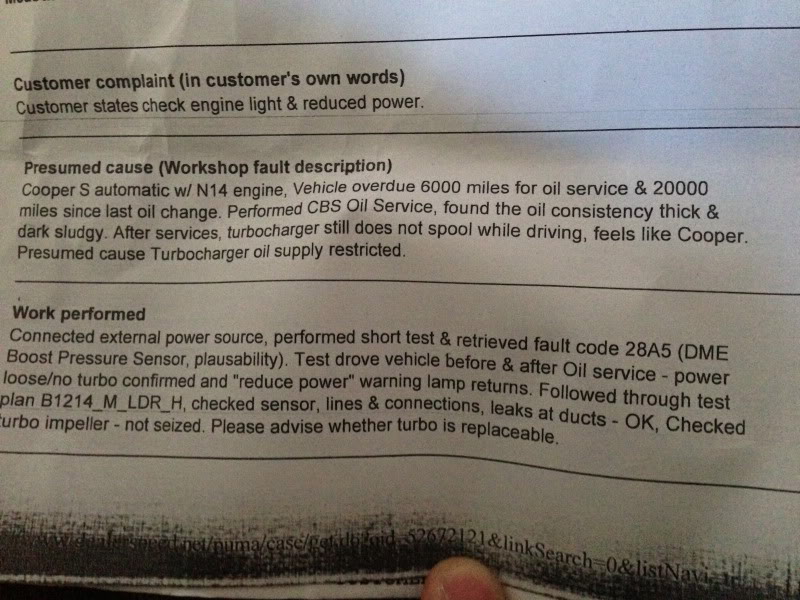

Before I took it to the dealer for service, the car wasn't noisy, did not stall and although it had reduced power it functioned. After the dealer serviced it and changed the oil, it got really loud, started to stall and yesterday it finally went dead.
When I picked it up I noticed the noise which wasn't there before and asked about it, I spoke to the mechanic who serviced it and like a few people here have said, he basically said it was because now that there is fresh oil things are moving freely.
I drove 25 miles home from the dealer, it died the next day after driving for about 5 minutes as I was moving it to a parking spot until I could figure out what to do and where to take it for service. I wanted to get some quotes from other places, unfortunately since I can't start it I just called roadside and had them tow it to the dealer and I'm going to have them do the work.
Here is what the paper work I received says:

So my first thought was that a turbine was seized up creating un-manageable back pressure (its exhaust driven remember)...however the paperwork you showed indicated that is not the case.
I'll be honest I don't know -- I am hoping you didn't ingest parts of the impeller or something into the engine...turbos feed air and whatever else they get into the engine at a high rate of speed. That being said impossible for me to know over the internet but should be a concern your service advisor addresses while the car is in. From what others have said looks to be a 1-2 day job maximum...let us know what happens when you get the car back.
