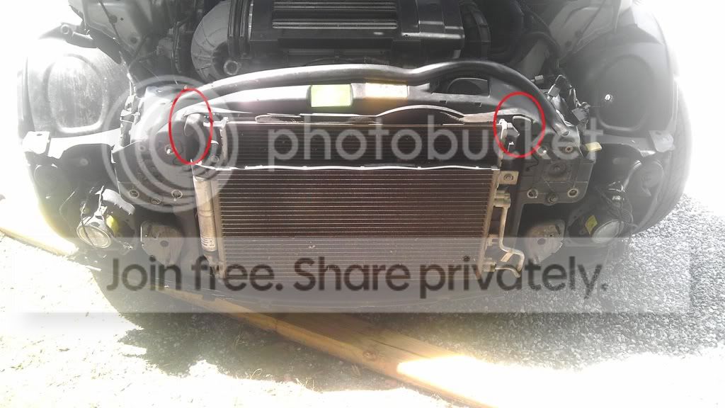

Once the crash bar is removed, you are left with this....
Now we are to loosen up this fan shroud/condenser/radiator setup.
In the picture shown below you will see 2 circles in red, in these circles will be 2 push pins, just simply grab those diagonal cutters and pull the center pin out, and once it pulls out, pull the whole piece out with the rubber pieces with holes in them that are still present in the picture!
Now with that done, we need to remove that top radiator hose from the neck of the radiator. My hose has an aftermarket worm clamp on it so I used a screwdriver to take it off, yours might still require pliers because it is the OE squeeze clamp. Be careful to make sure the coolant isnt piping hot when you start to do this, or that there isnt any pressure on the system, if not sure just slowly loosen the coolant reservoir cap to relieve the pressure on the system. Slide that catch can/drain pan/bowl whatever you have handy underneath the passenger front side of the car relevant to the radiator hose position to catch that coolant!
Now that you have the radiator hose off, the whole assembly should have some play to it. Try putting your hand on her and softly pulling forward to see if you have the same amount of play as pictured below!
